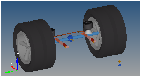

Rear Single Solid Axle Suspension with Trailing Arm
The rear axle suspension system includes trailing arms, an air spring, and a shock
absorber. The shock absorber and the air spring both extend from the trailing arm to
the frame and mount to the trailing arm at a position rearward of the axle. The use
of trailing-arm in the rear wheels allow for a flatter floor and more cargo room
especially in commercial vehicles. Figure 2.

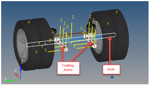

Trailing Arm
Trailing-arm suspension is a design in which one or more arms are
connected between the rear axle and the chassis, toward the front of the
vehicle. This allows the rear to move up and down.Figure 3.

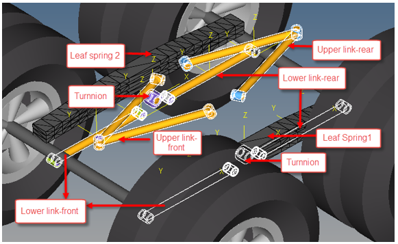

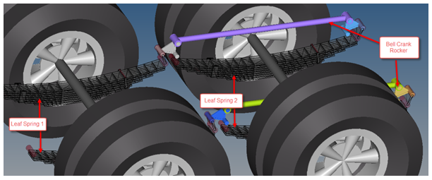

Bell Crank Linked Leaf Springs
In the bell crank linked leaf springs, two sets of leaf springs are used
and is mounted to the frame at two points. Bell crank rocker is attached
in the rear-rear leaf spring. It is used to convert translational motion
of one object into translational motion of another object operating at
different angles. It acts as an equalizer when the load is applied.Figure 5.

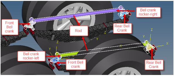

The main Body parts included in the Bell crank rocker is shown in the
following image.Figure 6.
