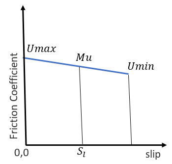

Friction Coefficient
The friction coefficient can be calculated in three ways:- Interpolating the Umax and Umin value using Comprehensive slip.
Figure 2. Friction Coefficient versus Slip
- Interpolating Mu using Vertical Force from a table.
- Interpolating Mu using Slip from a table.
Option 1 is the default option. Option 2 or 3 can be used when you have a table representing Mu versus Vertical Force or Mu versus Slip as shown below:
