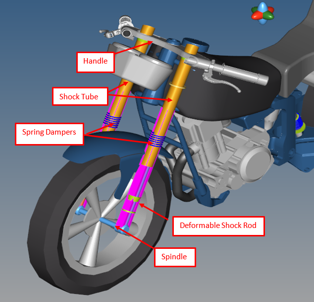

Rigid
Bodies (slider and fork tube) are rigid entities constrained by a translational joint
to allow the sliding action and a revolute joint to facilitate steering.Figure 1.
Deformable
The strut rod is a flexible member constrained by a PTCV joint. This modeling
approach allows the rod to bend/flex thereby introducing compliance in the fork
assembly.Figure 2.
