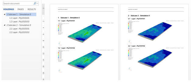

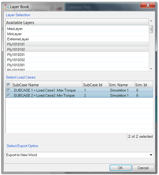

- Export to New Word
- Select the combination from the graphical user interface and a new Word Document
will be generated with a new chapter for each load case, each one having as many
sub-chapters as the number of selected layers.For example, the following combination (2 layers – 2 load cases) will generate a document with two chapters and two sub-chapters:

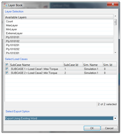

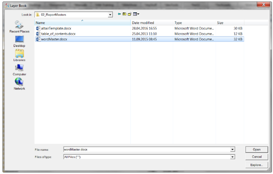

- Export Using Existing Word
- This approach is similar to the previous one, however you will be asked, after the
selection, to point to an existing document or template. The organization of the

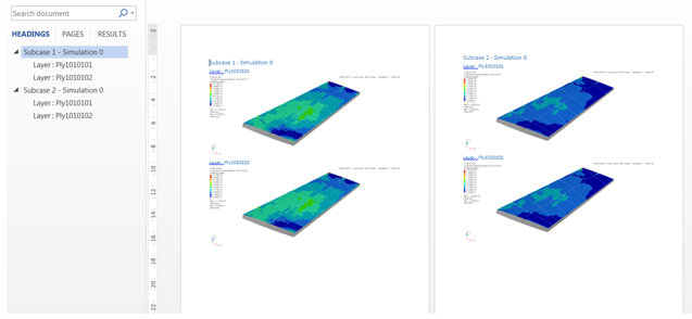

chapters is the same as the previous use case, however the headings will be taken from
the document set up.For example, the following option selections:
With:Figure 4.
Results in:Figure 5.
