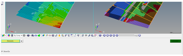

Next, you have to contour the needed result in a
contour plot and then you can run the application.
Two options are available:
Quick Query
Append Multiple Results
Quick Query
With Quick Query, you can select one element only and will get a HyperGraph pop-up window showing the needed results.Figure 1. Figure 2.
