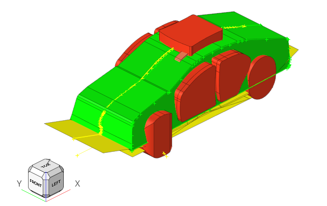

- Click the Design Space ribbon.
Click the Global tool to create global voxel mesh.

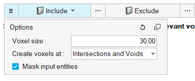

Click
on the guide bar and set the voxel size to 30.
Leave the other options as default.Figure 3.
Click
next to Include, select auto 1, and then click OK.
Alternatively, you can also pick the components to be included by selecting them from the modeling window.
Click
next to Exclude, select all the components besides auto 1, and then click OK.
Similarly, you can also pick components directly from the modeling window.

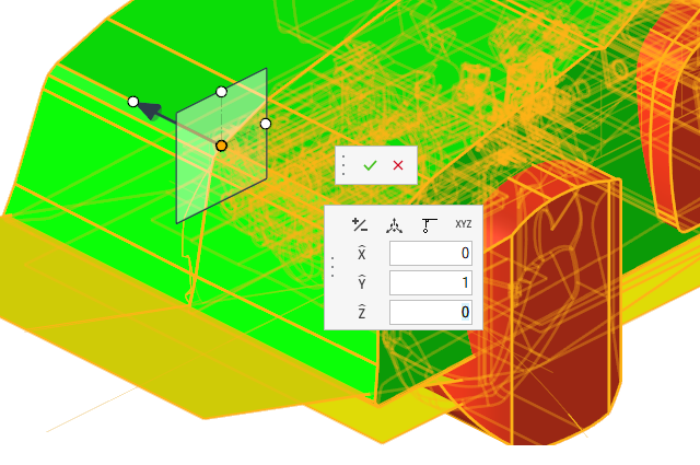

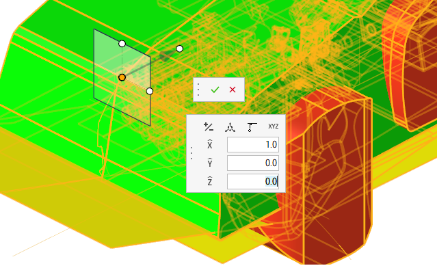

- Optional:
Define a symmetry plane.

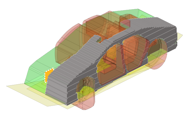

Click Create on the guide bar to
generate the voxel mesh.
Figure 6.
