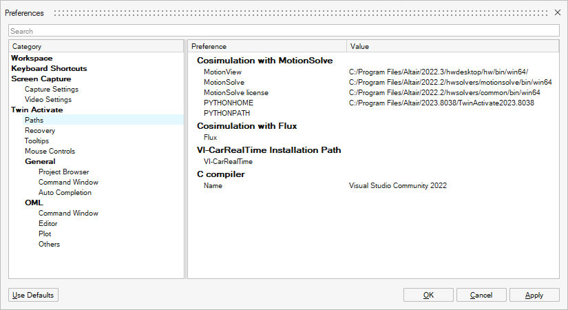

Defining the Software Path Settings
Defining the paths to MotionSolve and other software that is required for local and remote co-simulation methods.
From the File menu, select the Preferences button.
The Preferences dialog appears.
On the left column of the dialog, select the category, Twin Activate
Paths.
For each preference, enter an installation path, and click
Apply.
Preference Path MotionView <HyperWorks_install_path>/hwdesktop/hw/bin/platform MotionSolve <HyperWorks_install_path>/hwsolvers/motionsolve/bin/platform MotionSolve License (Radflex) <HyperWorks_install_path>/hwsolvers/common/bin/platform Python (For HyperWorks 2021): <HyperWorks_install_path>/common/python/python3.5/platform
(For HyperWorks 2020): <HyperWorks install_dir>/hwdesktop/common/python/python3.5/platform

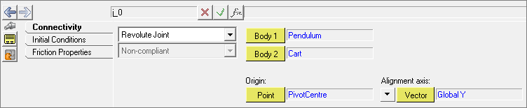

Insert a revolute joint, label it PendulumPivot, and
set the Connectivity parameters as follows:

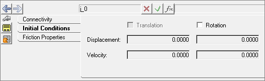

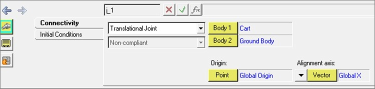

Insert a translational joint, label it CartTranslation,
and set the Connectivity parameters as follows:
Set the Initial Conditions as follows:

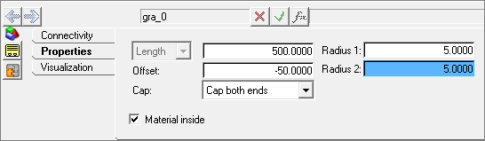

- Insert a cylinder graphic and label it Rail.
- For the Connectivity parameters, set the parent body to Ground Body; origin to Global Origin; and direction to vector Global X.
Set the Properties as follows:

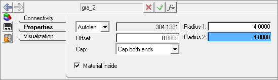

- Insert a cylinder graphic, and label it Rod.
- For Connectivity parameters, set the parent body to Pendulum; set the origin to PendulumCenter; set the direction to the point PivotCenter.

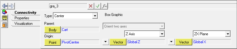

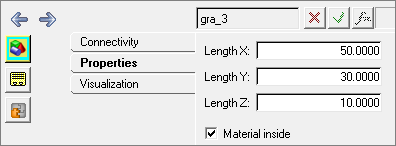

- Insert a box graphic, and label it Cart.
For Connectivity parameters, set the Type to Center; set
the Parent Body to Cart; set the Origin Point to
PivotCenter; set the Z axis direction to Vector
Global Z; set the ZX plane direction to Vector
Global X.

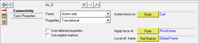

Adding Forces
Apply translational forces to the Cart.
On the Connectivity tab, add the force, frc_0, label it
Control Force, and set the Connectivity properties as
follows:

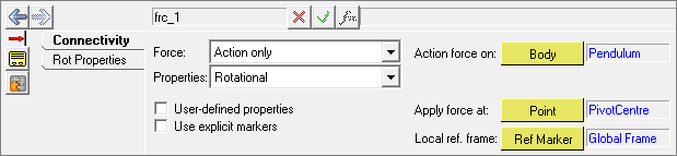

On the Connectivity tab, add a second force, frc_1,
label it PivotTorque, and set the Connectivity properties
as follows:

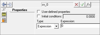

Adding Solver Variables

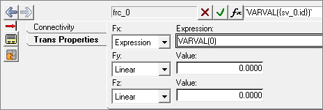

Create two solver variables: ControlForce (varname: sv_0)
and PivotTorque (varname: sv_1) as follows:

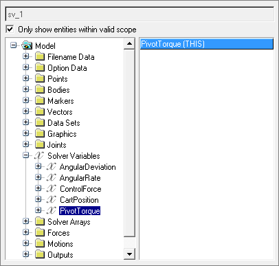

Connect the two solver variables to the forces you created in the previous
section, Adding Forces.

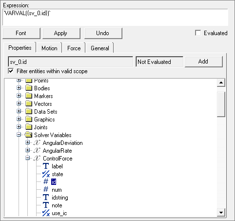

As you see in the following figure, on the Trans Properties tab for ControlForce, for Fx, select Expression, and for f, enter: `VARVAL({sv_0.id})`. This expression specifies the ControlForce to be the first solver variable, sv_0. This variable sets the control signal sent from Twin Activate to be the control force acting on the translational joint of the Cart.
Verify that the varnames match (sv_0): From the Expression
Builder, select the solver variable by name and enter its ID as you see in the
following figure:

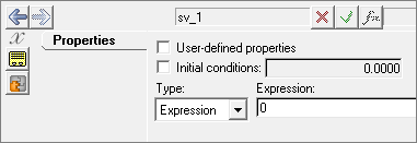

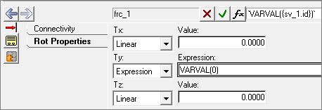

On the Rot Properties tab for PivotTorque, for Ty, select
Expression, and then for f,
enter:`VARVAL({sv_1.id})`. This expression sets the
PivotTorque as the second solver variable, sv_1, which
specifies the control signal sent from Twin Activate as
the torque acting on the rotation of the pendulum.

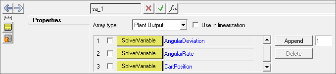

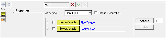

Insert two solver arrays. Label them ControlInput and
PlantOutput.
The ControlInput solver array includes both the PivotTorque and ControlForce
solver variables. Set the properties as follows:
The PlantOutput solver array includes the following solver variables:
AngularDeviation, AngularRate and CartPosition. Set the Plant Output properties
as follows:

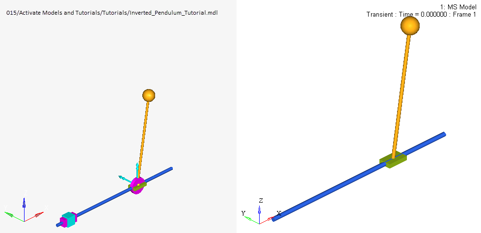

Validating the Inverted Pendulum Model
Simulate the MBS model in MotionSolve and validate that it performs as required.

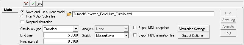

- From the Run panel, select: Save and run current model.
- Select the folder icon, and enter a path and name for saving the MotionSolve model (XML file). The name is your choice, but a good practice is to use the same root name as your MotionView model. The solver run requires the XML file. When entering the path, note that the default directory of the tutorial may not be writable, and you may need to specify a different directory or change the write permissions on the directory.
From the Run panel, save your model as an XML file. This file is used for the
solver run as well as the Twin Activate model. Alternatively, you can run the
MotionView .mdl file, and name it
Inverted_Pendulum_Tutorial.xml.
Animate the results from the simulation and confirm that the model works as
intended before continuing to the next steps. The controller is not yet
connected to the model, therefore the input force and torque are zero.

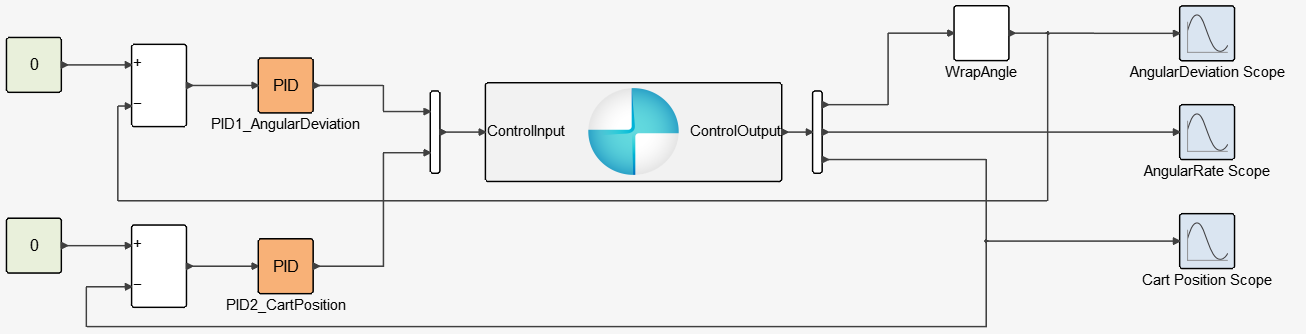

The controls system model requires these blocks:
| Block | Description |
| MotionSolve | Enables the embedding of a MotionSolve model into an Twin Activate model. |
| Mux | Reads multiple signals into one signal. |
| Demux | Reads a signal which contains multiple components and splits the signal into individual components. |
| OMLCustomBlock | |
| Scope | Plots data as defined. |
| Constant | Generates a command signal. |
| PID | Serves as the controller block, the brain of the model. |
| Sum | Calculates the error from reference signals and feedback. |
Creating the Diagram of the Twin Activate Model
- On the ribbon, select .
- From the Palette Browser, select , then drag and drop one MotionSolve block into the current diagram.
In the diagram, on the MotionSolve block, double-click.
From the dialog that appears, define the following block properties:
For this property Do this XML or MDL input file name Copy and paste the path to your MotionView .mdl model or MotionSolve .xml file. Output MRF file name Enter a path to an output multi-body results file. Direct feedthrough Clear the check box for this option. Direct feedthrough defines if the outputs of a block are directly affected by the inputs. An example is a gain block where y = K*u, which causes algebraic loops. If this result is not desired, clear the check box to break the loops.
Note: The following parameters are populated automatically after you load the input model, *.mdl or *.xml:This parameter Is defined with this value Input Row Size The value 2 indicates that two signals from the Twin Activate model are supplied to the MotionSolve model. These signals correspond to the solver array PlantInput, with variables PivotTorque and ControlForce. Output Row Size The value 3 indicates that the MotionSolve model sends out three signals from one port, which is why the Demux block is added to separate the signals. The signals correspond to the solver array ControlOutput with variables AngularRate, AngularDeviation and CartPosition. - In the Palette Browser from , drag and drop one Sum block into the diagram.
- In the Palette Browser, from , drag and drop one Demux and one Mux block into the diagram.
- On the DeMux block, double-click, and in the block dialog, for Number of outputs, enter 3.

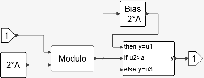

Do one of the following:
- Create a super block that includes a function to limit an angle between
-180º and 180º. An example is shown below.
- Alternately, add an OmlCustomBlock. In the block dialog box, select the
SimFunction tab, and enter the following function
in Function Code:
function OmlBlockFunction(block,flag)angle=vssGetInPortData(block,1);if flag==vssBlockOutputUpdateFlagx= mod(angle(1),360);if(x>180)x=-360+x;endvssSetOutPortData(block,1,x,vssGetOutputDataType(block,1));endend
In the Palette Browser, from , drag and drop three Scope blocks into the
diagram.
The Scope blocks correspond to the responses of AngularDeviation, AngularRate and CartPosition. Define the scope block parameters for axis and curve properties for these responses.
- In the Palette Browser, from , drag and drop two PID blocks into the diagram.
- Select the first PID block. From the Property Editor, select , and enter the name PID1_AngularDeviation.
- Select the second PID block. From the Property Editor, select , and enter the name: PID2_CartPosition

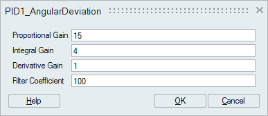

On the block, PID1_AngularDeviation, double-click, and
enter these values for the parameters:
Note:- Proportional Gain multiplies the error signal by a constant gain Kp.
- Integral Gain multiplies the sum history of error with integral gain Ki.
- Derivative Gain multiplies the rate of change of error with gain Kd.

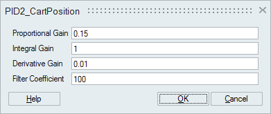

On the block, PID2_CartPosition, double-click. In the
dialog, define the parameters:
- In the Palette Browser, from , drag and drop one Constant block into the diagram.
- On the Constant block, double-click. In the dialog, for Constant, enter 0.
- Select the Constant block, and copy and paste it into your diagram so that you have a duplicate.
All of the required blocks are now present. Assemble and link the blocks in the
diagram as follows:
- Experiment with the diagram and try to modify the PID gain parameters to see their effect on the simulation.

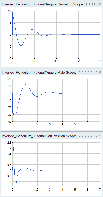

On the ribbon, select Run.
The Scope blocks in the model generate the following plots for the cart: Angular Deviation, Angular Rate and Cart Position.
- Experiment with the diagram by modifying the PID gain parameters and evaluating their effect on the simulation.
