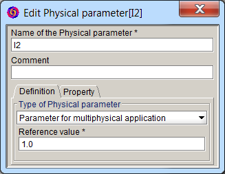

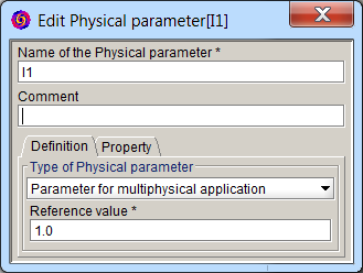

The inputs for the IPM motor are defined as multi-physical parameters and include:
- I_1: Physical quantities: μr, Bs, Br
- I_2 Electrical quantities: resistance, voltage, current
- I_3: Mechanical quantities: position, speed, electromagnetic torque

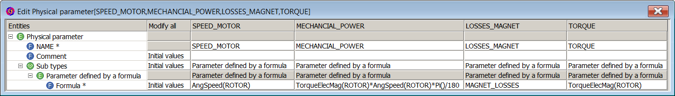

The outputs for the IPM motor are scalar I/O settings that retrieve values through the sensors, formulas (torque) and parameters (position, speed, acceleration).

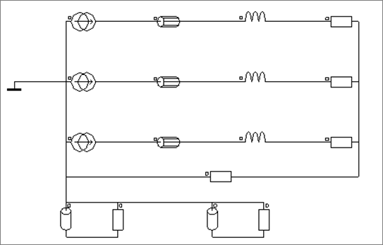

The circuit of the IPM motor is configured with a current source, coil conductor, resistor and inductance.

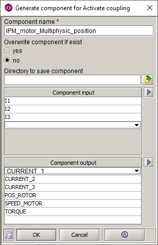

In the dialog, enter the following information for the component:

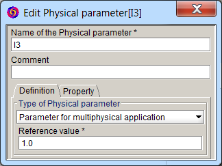

- Enter the name for the component: IPM_motor_Multiphysics_positionF2STA
- Enter the path to your working directory: <name_without_spaces>
- Select the input (geometric I/O parameters) for the component: I1, I2, I3

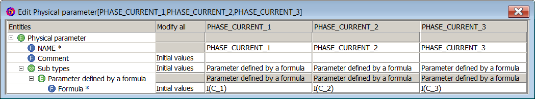

- Select the output: PHASE_CURRENT_1, PHASE_CURRENT_2,PHASE_CURRENT_3, TORQUE, SPEED_MOTOR and POS_ROTOR
The dialog should look something like this:
Click OK.

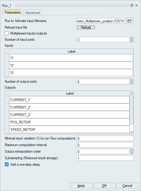

- From the Palette Browser, select , and drag one Flux block into your diagram.
- Double-click the Flux block. In the block dialog, for Flux to Activate input filename, enter the path to the coupling component you generated from Flux: <working_directory>/ IPM_motor_Multiphysics_position.F2STA.F2STA.
Click OK.
The Flux block populates with the model data from the Flux coupling component.
For the last three fields in the Flux block dialog, enter these values:
- for Numerical memory (MB), enter 2721.
- For Character memory, enter 200.
- For Minimal input variation %, enter 10.
Click OK.
The Flux block dialog should look something like this:

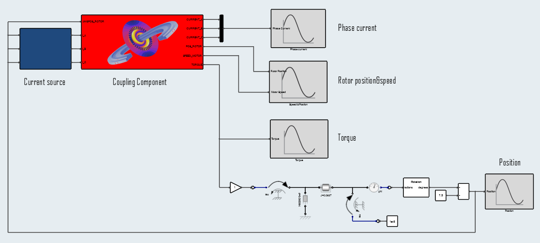

Assemble and connect the blocks as you see in the following figure, and save
the model.
Figure 3. Flux block assembled with inputs and outputs
The Twin Activate model is complete and configured to supply the Flux model of the IPM motor with three currents.

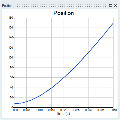

On the ribbon, select Setup.
- On the dialog that appears, select the Simulation Time tab.
- For Final Time, enter .0125. Keep the defaults for the remaining fields.
- Select the Solvers tab. For the solver, select Forward Euler, and click OK. Keep the defaults for the remaining fields.

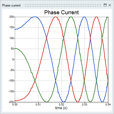

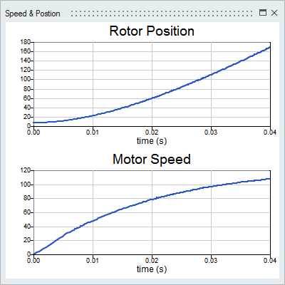

On the ribbon, select Run.

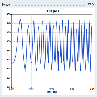

The simulation results show the currents fed into the motor and the motor performance.Figure 4. Phase current (A), rotor position (deg), motor speed (deg/s), torque (Nm) and position (deg)

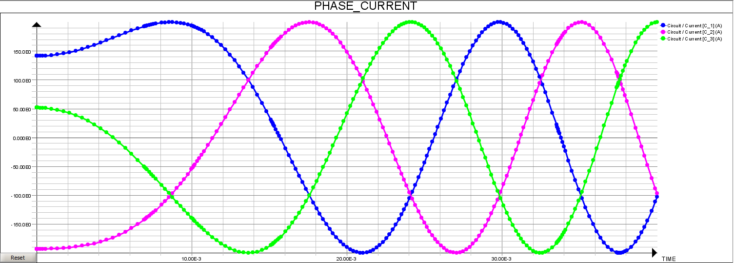

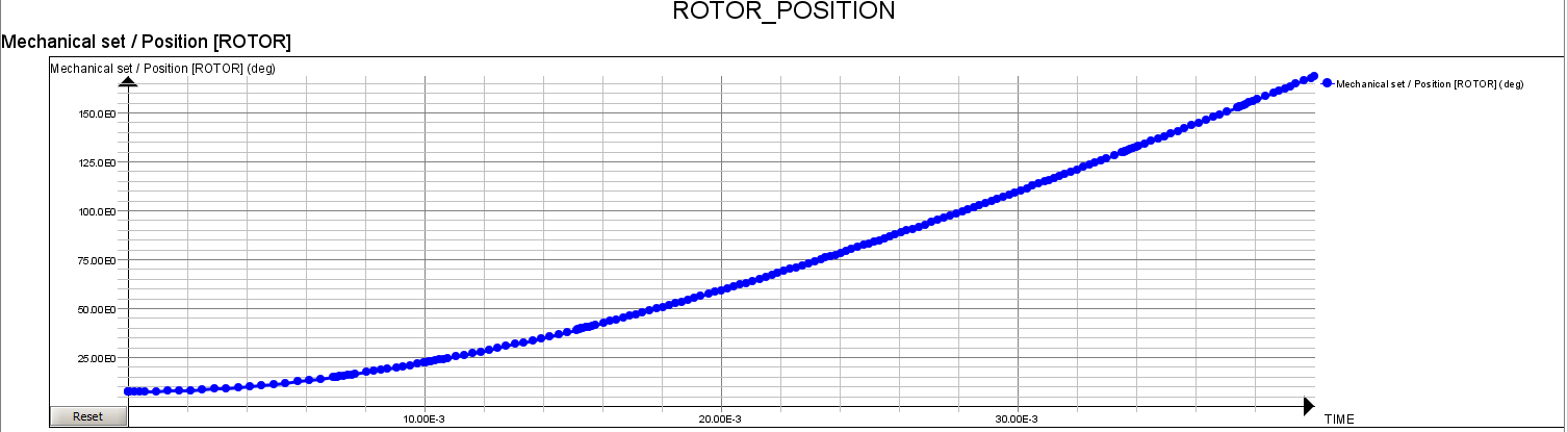

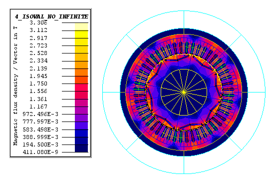

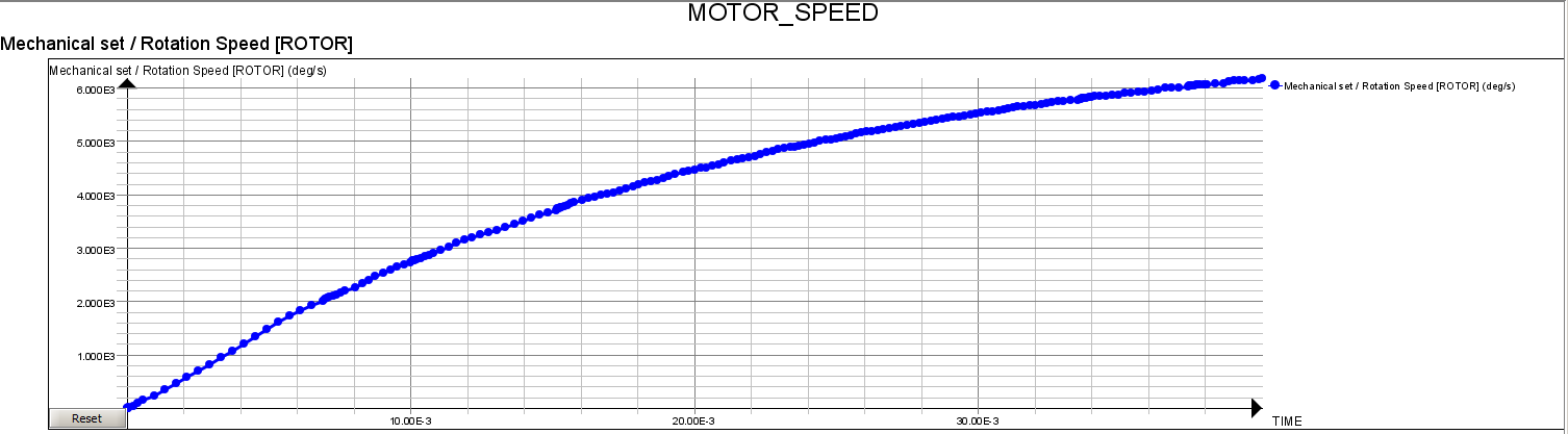

Flux post-processing results show density isovalues; phase current, rotor position, motor speed, torque and position.
Figure 5. Flux density isovalues
Figure 6. Phase current (A)
Figure 7. Rotor position (deg)
Figure 8. Motor speed (deg/s)

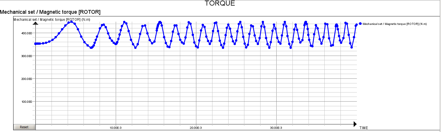

Figure 9. Torque
