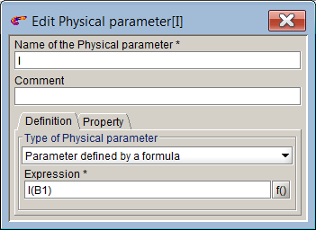

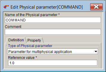

The inputs for the plunger are defined as multi-physical parameters and include:
- Command: the control of the switch
- I: the current in the coil conductor
The outputs for the plunger are scalar I/O settings that retrieve values through the sensors, formulas (forces and couples) and parameters (position, speed, acceleration).

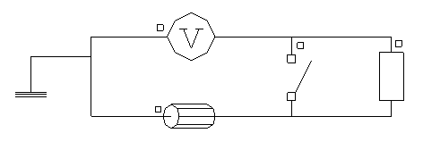

The circuit of the plunger is configured with a voltage source, coil conductor, resistor and switch.

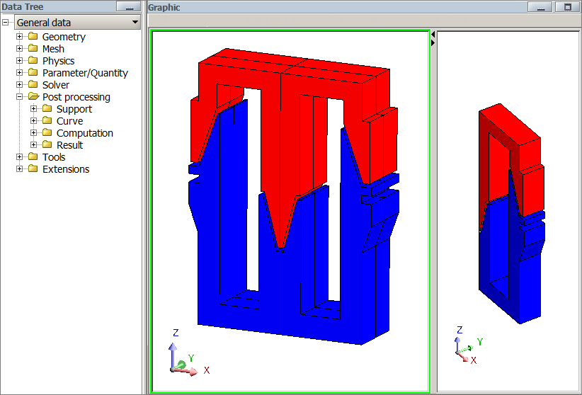

Launch Flux, and from your working directory, open the project,
TRANSLATING_MOTION_COUPLING.F2STA.
The model loads and looks something like this:
Figure 2. Split View of Plunger

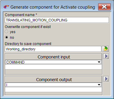

In the dialog, enter the following information for the component:
- Enter the name for the component: TRANSLATION_MOTION_COUPLING.
- Enter the path to your working directory: <name_without_spaces>.
- Select the input (geometric I/O parameters) for the component: COMMAND
- Select the output: I.
The dialog should look something like this:
Click OK.
The coupling component is saved to your working directory as TRANSLATING_MOTION_COUPLINGF2STA.FLU.

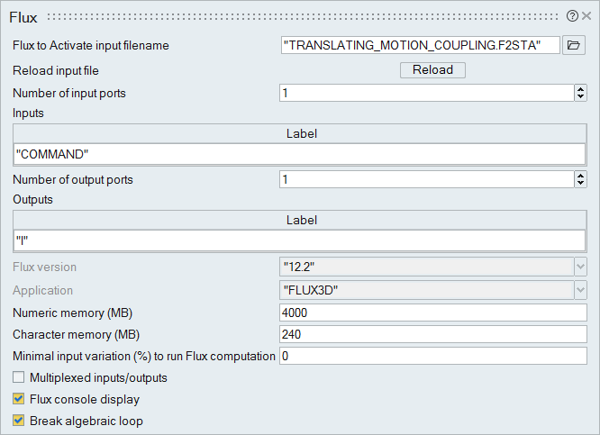

- From the Palette Browser, select , and drag and drop one Flux block into your diagram.
- Double-click the Flux block, and in the block dialog, for Flux to Activate input filename, enter the path to the coupling component you generated from Flux: <working_directory>/TRANSLATING_MOTION_COUPLING.F2STA.
Click OK.
The Flux block populates with the model data from the Flux coupling component.
For the last three fields in the Flux block dialog, enter these values:
- For Numerical memory (MB), enter 4000.
- For Character memory, enter 240.
- For Minimal input variation %, enter 0.
Click OK.
The Flux block dialog should look something like this:

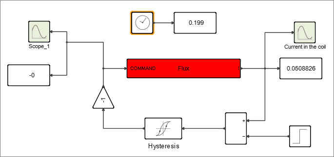

In the diagram, add and define these blocks:
Add blocks Define the block options with these values Time Default Display 1 Default Display 2 Default Display 3 Default Scope 1 Default Scope 2 Default Gain Gain = -1 Hysteresis
Sum Number of inputs = 2 Step Generator Step time = .07
Initial value = 1
Final value = .075
Assemble and connect the blocks as you see in the following figure, then save
the model.
Figure 3. Diagram Assembled with Flux Block
The Twin Activate model is complete and configured to supply a current to the Flux model of the plunger.

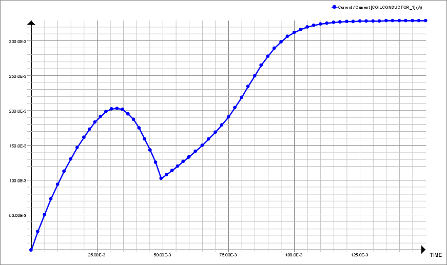

On the ribbon, select Run.

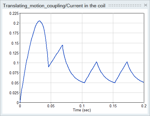

The scopes in the Twin Activate model plot the simulation results of the current fed into the coil of the plunger.Figure 4. Current/Coil Conductor_1 (A) Without Regulation
Figure 5. Current Coil Conductor With Regulation
