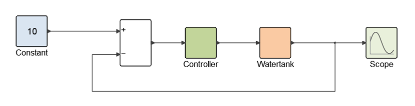

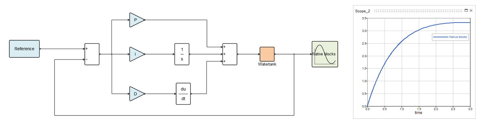

In this case, a dynamic model of a controlled water tank, where a reference level signal is set, uses a PID controller to make the plant reach the right water level:
This entire model is exported as an FMU with input and output ports. In Panopticon, a dashboard is created to parametrize the FMU parameters P, I, and D and to run the dynamical model and get the outputs.

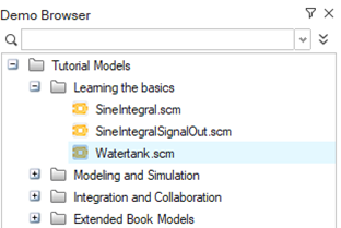

In this tutorial, a standard Twin Activate demo is used from the Demo Browser, but the process should be the same across any other diagram.
In Twin Activate, select .

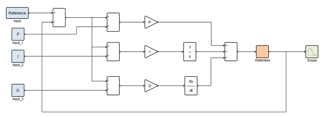

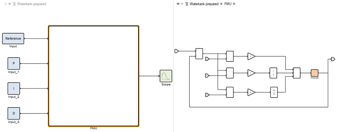

Rearrange the system to have four inputs and one output to be exported as FMU
further.
- Remove mask from Controller.
- Expand Controller super block.
- Add, e.g., Constant blocks as inputs.
- Reference water level (Input)
- P (Input_1)
- I (Input_2)
- D (Input_3)

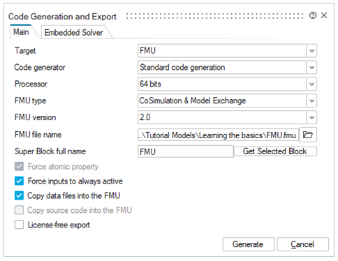

from the menu ribbon.You can also right-click on the super block and select Code Generation and Export.
Select FMU for Target, select an
FMU file name, and click
Generate.

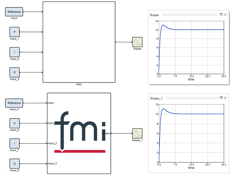

To validate the new FMU, insert an FMU block from the
Palette Browser under and check the results.

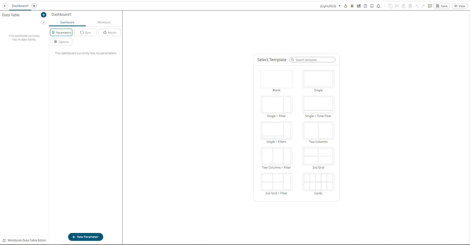

Panopticon Workbook

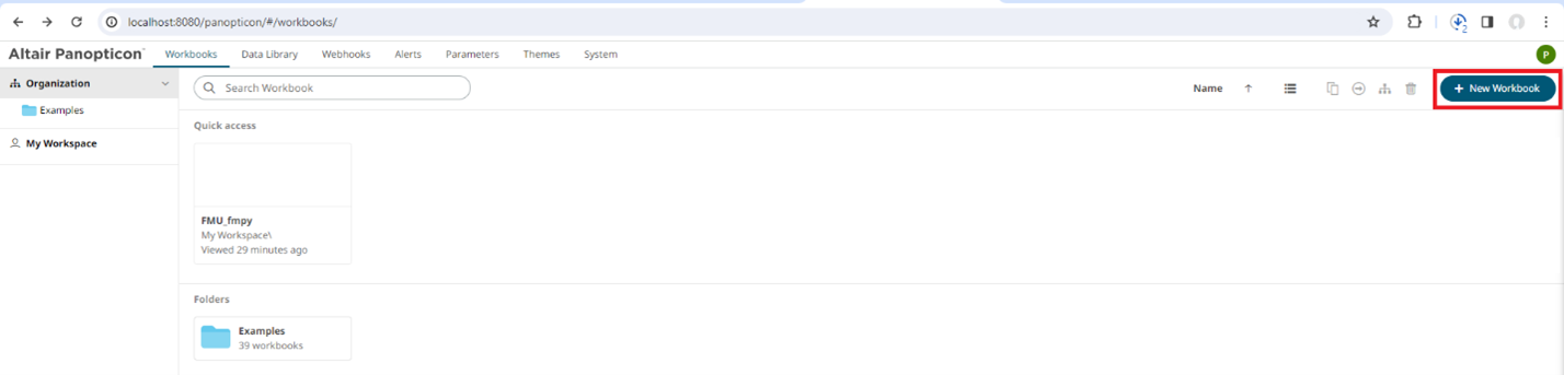

A new workbook must be created to set the environment to run the FMU without the need of Twin Activate.

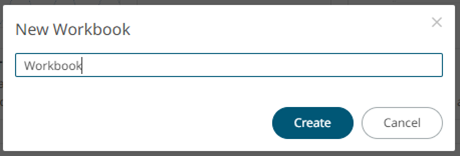

In the Panopticon main page, click New
Workbook, enter a name, and click Create.
After creating the workbook, select a Template.

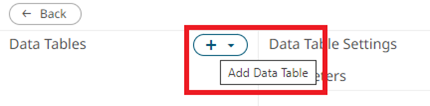

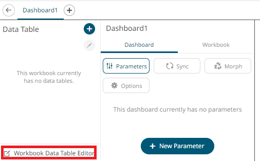

Open the Workbook Data Table Editor.

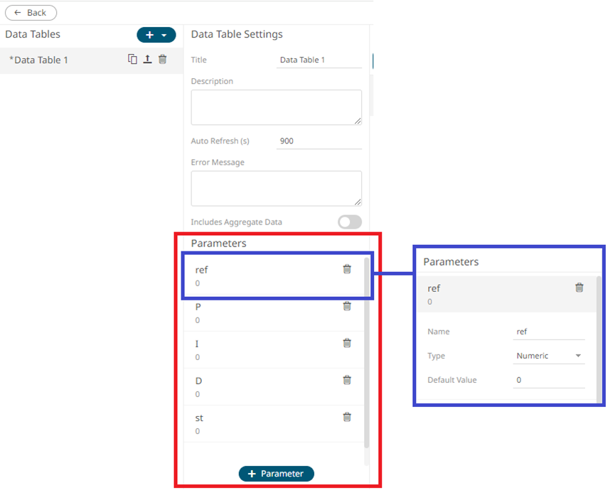

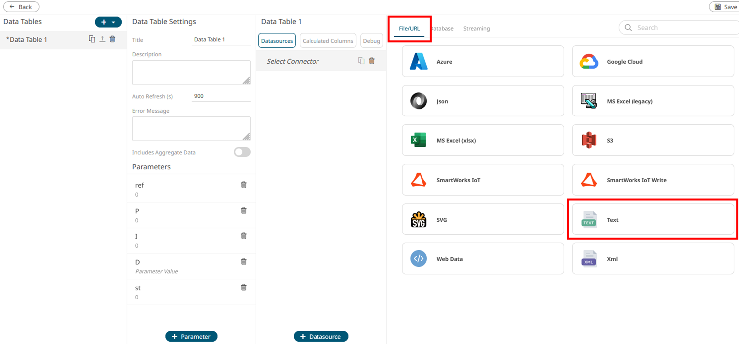

Click the + icon to add a new data table.

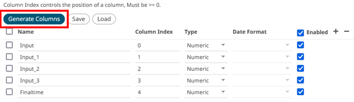

Click + Parameter to add five numeric parameters.
Besides the four parametrized variables mentioned before (Reference water level, P, I, and D), there will be one more, the final simulation time st. The variables are set as Numeric, and they can be freely named.
Select

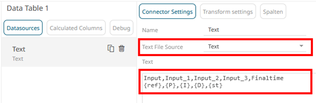

Change the Text File Source to
Text.
The following text is used to create a table using the parameters created in the data table:
Input,Input_1,Input_2,Input_3,Finaltime {ref},{P},{I},{D},{st}
After you insert the text, click Generate Columns to
populate with the parameters.

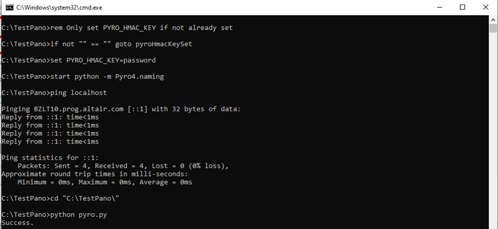

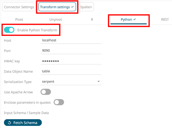

In Enable Python Transform and enter
the HMAC key from the Pyro.
, select The standard key is password.

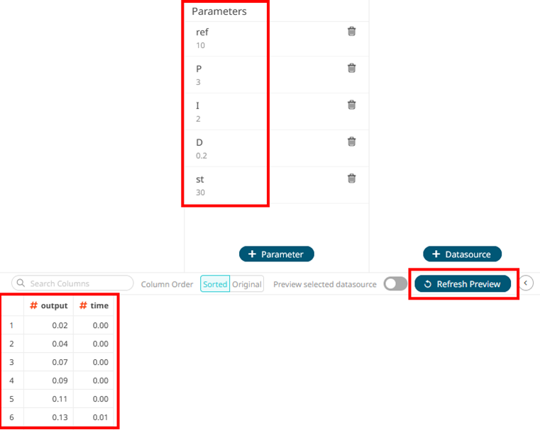

Assign some values to the parameters in the Data Table editor and click
Refresh Preview to see if the FMU works.

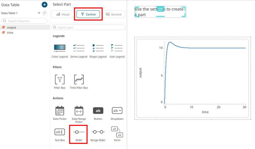

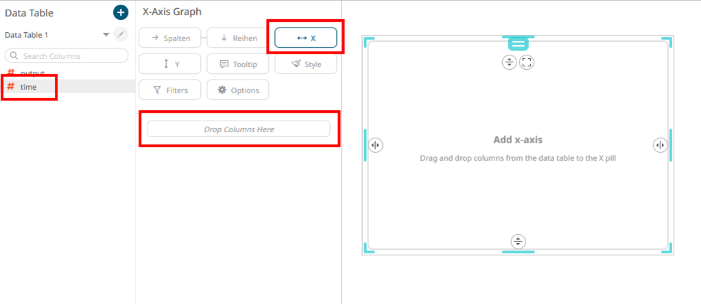

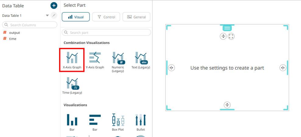

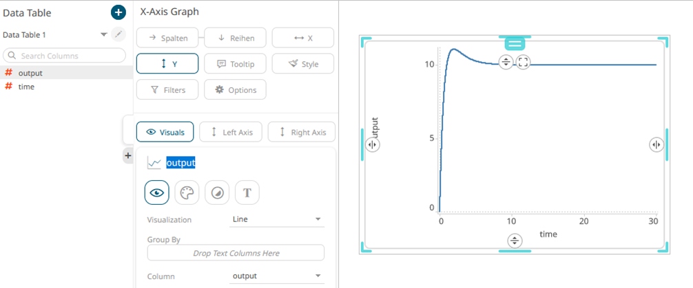

To add an x-axis graph, click and drag a rectangle on the dashboard and select
Assign time to X and output to Y by dragging and dropping.

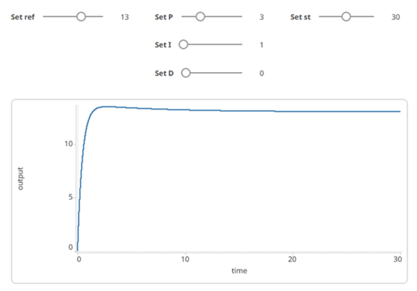

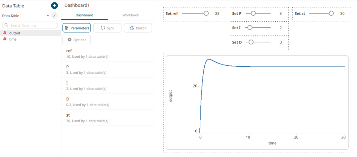

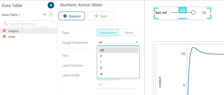

Click
to add sliders for each parameter and assign the
parameters.

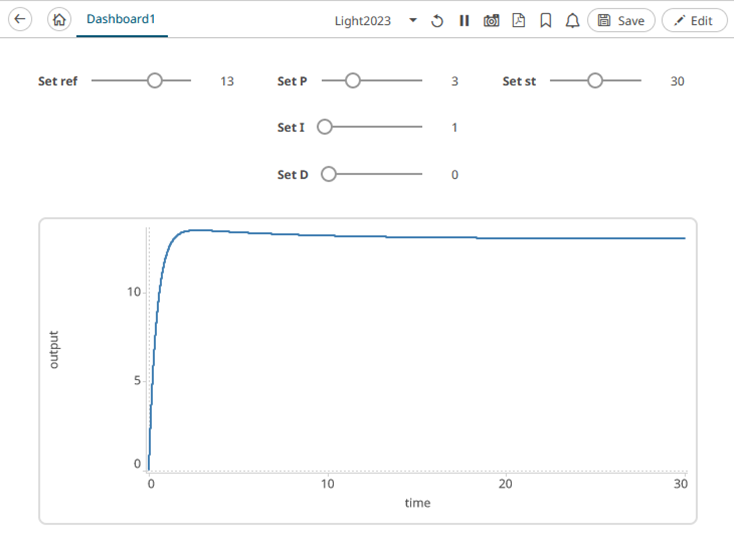

Save the changes and click View to leave the edit mode.
Change the parameters to run the FMU and see results in the graph. Each time a
parameter is changed, the FMU is executed and the graph is updated.

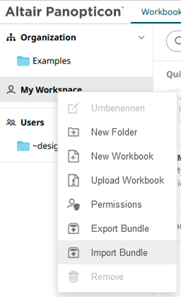

The final version of the Panopticon dashboard is available with the FMUinPano.exz bundle. To import it, right-click on My Workspace and select Import Bundle.
