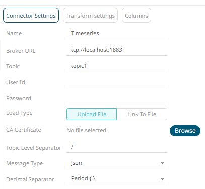

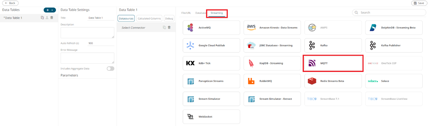

Click the + icon to add a new data table.
After adding a data table, select from the page that opens.
Enter a Topic name, in this case
topic1.

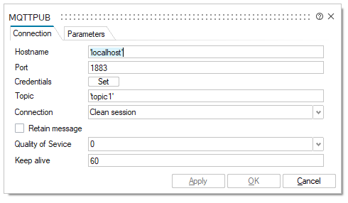

Open the block's Connection tab. Set the
Hostname and Topic
fields:

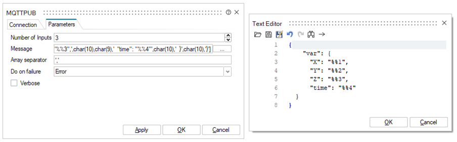

Open the Parameters tab. Enter the Number of
Inputs, in this case 3, and the
Message. It is a good practice to use JavaScript
Object Notation (JSON) format to send data to Panopticon:
{ "var": { "X": "%%1", "Y": "%%2", "Z": "%%3", "time": "%%4" } } -

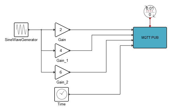

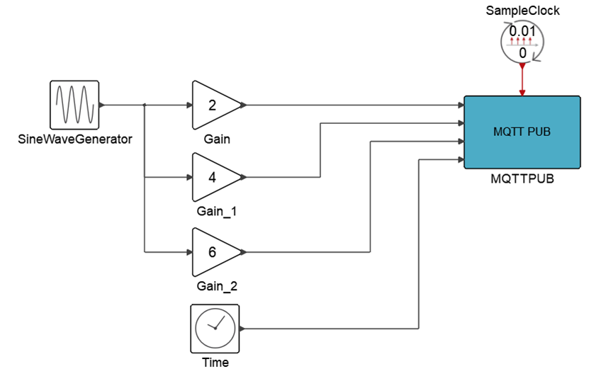

After doing the setup for the MQTT PUB block, connect some of the Signal
Generator blocks to the inputs, a Gain for each of them, and a SampleClock to
activate the block:

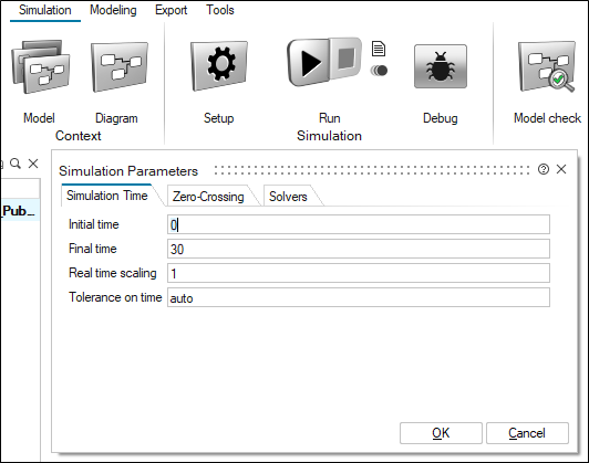

Open , and set Real time scaling equal to
1. The simulation will send data in real time to the
localhost.

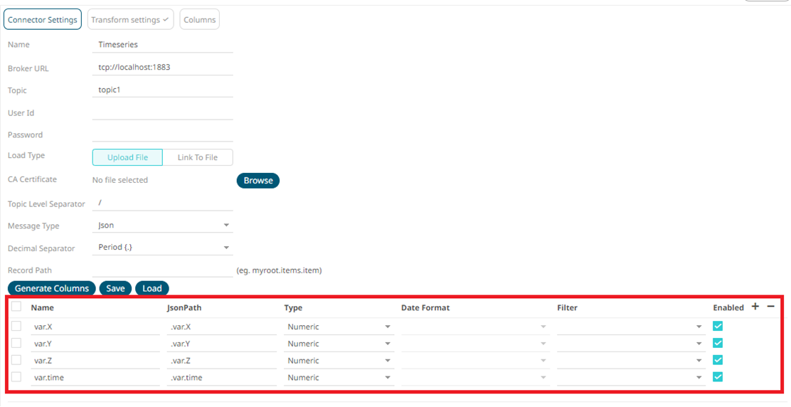

While the Twin Activate simulation is running, go to
Panopticon and select Generate
Columns.
Note: If Twin Activate is not running and sending data, selecting Generate Columns will generate an error. -
On Panopticon, after generating columns, these
parameters are shown automatically:

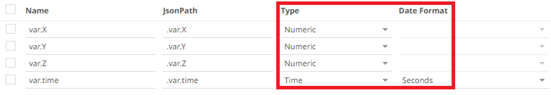

In this tutorial time variable was intentionally sent from Twin Activate, to be used in Panopticon as the time to be plot. Change the
Type to Time, and Date Format
to Seconds.

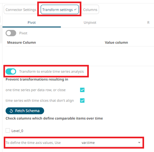

On the Data table editor, enable this analysis to time series. Open
Transform settings. Enable Transform to
enable time series analysis, and select
var.time to define the time axis:

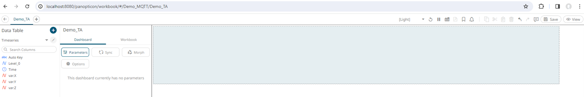

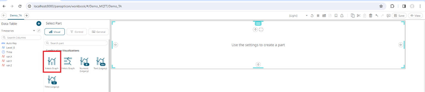

Press and hold in a certain area:

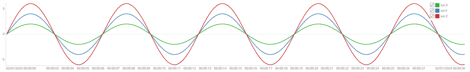

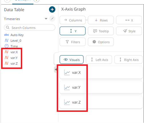

Select X-Axis Graph.
Drag and drop X, Y, and Z variables to Y option.

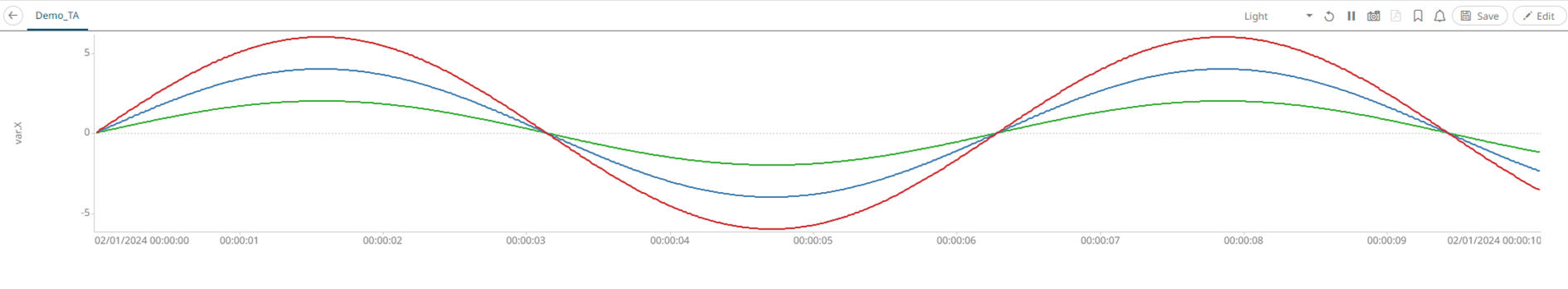

Select View and send data again from Twin Activate to visualize your data in real-time.

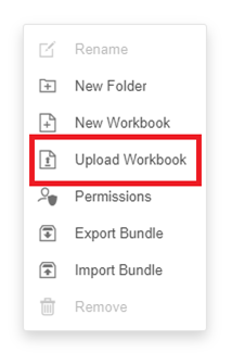

You can import a finished version of this dashboard using the Tutorial Dashboard TwinActivate.exw file inside the main page.
