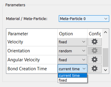

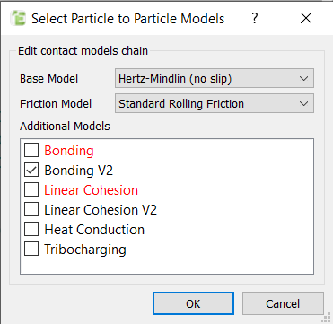

Bonds are created based on two methods - ‘current time’
or ‘fixed’. Once you have selected the Bonding V2 model, these options are displayed
in the Factory creating the Bulk Material or Meta-Particles.
- Current time allows the dynamic creation of bonded materials.
- Fixed time allows the creation of bonded material at one user-defined point
in time.
If the Bulk Material Active Bonds are defined and the Particles that comprise
the Bulk Material are in contact at the bond creation time, the bonds are formed
according the bond parameters. This occurs once per simulation for each particle
pair. Once the bond time has passed, no new bonds will be formed.

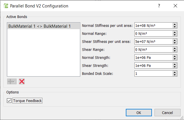

Select an active bond and then specify the Bond Formation method
and the following parameters:
| Interaction |
Configurable Parameters |
| Particle to Particle |
Normal Stiffness per unit
area Indicates the tensile/compressive
stiffness along the bond’s principal
axis. Normal
Range Indicates the applied Normal
Stiffness per unit area value assigned to the bond pair is a
value randomly distributed between the Normal Stiffness
value + or – the Normal range value. Shear
Stiffness per unit area Indicates the
Shear stiffness in the orthogonal plane to the bond’s
principal axis. Shear
Range Indicates the applied Shear
value randomly distributed between the Shear Stiffness value
+ or – the Shear range value. Critical
Normal Stress Indicates the maximum
normal stress the bond can withstand before it
fails. Critical Shear
Stress The maximum tangential stress
fails. Bonded Disk
Scale The radius of the cylindrical bond
between the particles will be equal to the smallest particle
radius in a bond pair multiplied by the bonded disk scale
value. Torque Feedback
- Enables the Bond Torque to be returned to the
Particle.
- Set the bond stress and stiffness values to
represent the material that is been modeled. A high
stiffness value will produce high bond forces and
stresses. A lower than normal Time Step may be
required to accurately capture these high
forces.
- When the Bond Formation Time is reached, all defined
particles in contact will be bonded together. Before
this time, particles interact based on the
Hertz-Mindlin contact model.
