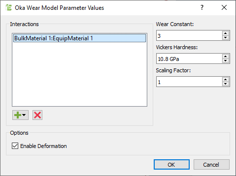

Using this model in EDEM requires the additional input
of the material’s Vickers hardness, Hv(GPa), the material’s Wear
Constant, WOka.

In the Oka Wear Model Parameter values dialog box:
- Select the Enable Deformationcheck box to enable Geometry deformation.
- If you select Enable Deformation, you must specify the Scaling Factor which allows the deformation results to be scaled as desired.
