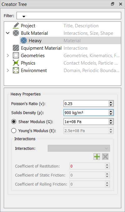

  1. In the Creator Tree, right-click Bulk Material and select Add Bulk Material.
  2. Rename the material to Heavy.
  3. In the Creator Tree, set the Solids Density property to 900 kg/m3.
    You will use the default values for other properties for this tutorial.
    Figure 27.

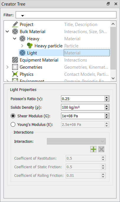

  10. In the Creator Tree, right-click Bulk Material and select Add Bulk Material.
  11. Rename the material to Light.
  12. In the Creator Tree, set the Solids Density property to 100 kg/m3.
    Figure 30.
  13. Click below Interaction to define the interaction properties for collisions among the heavy particles. In the dialog, select Heavy and then click OK.
  14. Click again to define the interaction properties for collisions among the light particles. In the dialog, select Light and then click OK.

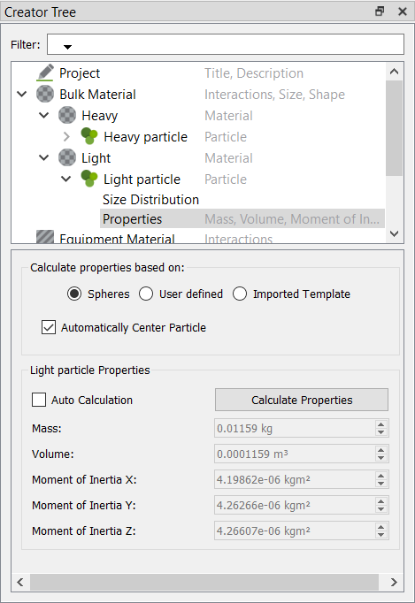

  15. In the Creator Tree, right click on Light and select Add Shape from Library > Dual Sphere Shape.
  16. Rename the particle to Light particle.

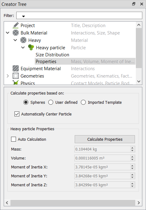

  17. Under Light particle, click Properties.
  18. In the Light particle Spheres panel, set the Physical Radius of both the spheres to 0.03 m and press Enter.
    Figure 31.
  19. In the Creator Tree, click Calculate Properties.
    Figure 32.

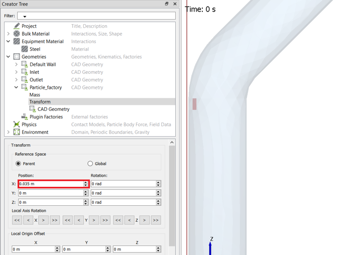

  8. Under Particle_factory, click Transform. Set the X-Position to 0.035 m
    Figure 34.
    Note: Set the Opacity value to 0.2 to see the transformed surface location inside the pipe geometry.
    This is done to make sure that the particles are generated inside the fluid domain.

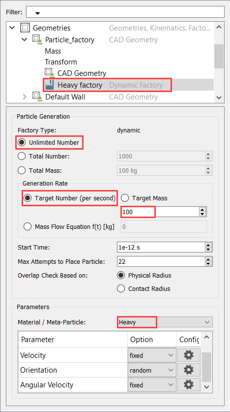

  1. In the Creator Tree, right-click Particle_factory and select Add Factory.
  2. Rename the new factory to Heavy factory.
  3. Set the particle generation parameters as shown in the figure below.
    Figure 35.
  4. Click besides Velocity, set the X-velocity to 1 m/s, and then click OK.
