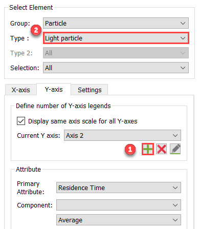

  14. Click the Y-axis tab. Create a plot of average residence time of the heavy particle over the simulation time by setting the values as shown in the figure below.
    Figure 56.
  15. Click to add another Y-axis and set the Type to Light particle.
    Figure 57.
  16. Leave all of the other options unchanged and then click Create Graph to create a plot of average residence time of both the particles.
    Figure 58.
    The plot in green is for the heavier particles and it can be observed that the average residence time is higher for the heavier particles compared to the lighter particles (blue).
