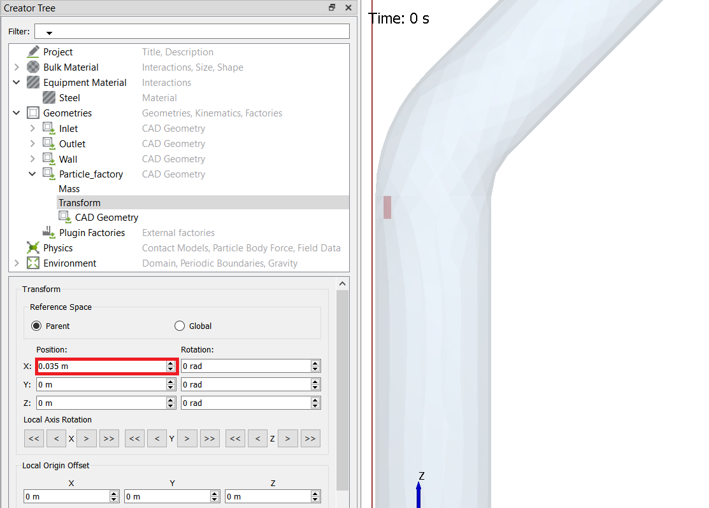

  8. Under Particle_factory, click Transform. Set the X-Position to 0.035 m
    Figure 30.
    Note: Set the Opacity value to 0.2 to see the transformed surface location inside the pipe geometry.
    This is done to make sure that the particles are generated inside the fluid domain.

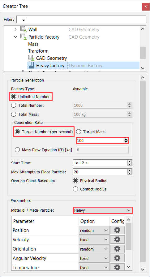

  1. In the Creator Tree, right-click on Particle_factory and select Add Factory.
  2. Rename the new factory to Heavy factory.
  3. Set the particle generation parameters as shown in the figure below.
    Figure 36.
  4. Click besides Velocity, set the X-velocity to 1 m/s, then click OK.
  5. Click besides Temperature, set the value to 363 K, then click OK.
    Note: The fields for Temperature and Heat Flux will not be visible unless heat transfer properties are defined.
  6. Repeat steps 1-5 to create another factory named Light factory using the same parameters but with Light as the Material.

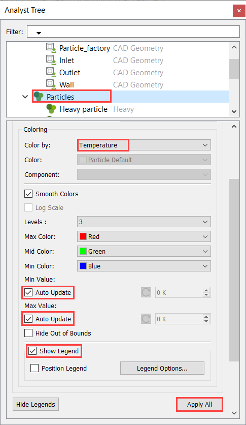

  1. Once the EDEM simulation is complete, click in the top-left corner to go to the EDEM Analyst tab.
  2. In the Analyst Tree, expand Display > Geometries and then click Wall.
  3. Verify that the Display Mode is set to Filled and set the Opacity to 0.2.
    Figure 52.
  4. In the Analyst Tree, click Particles.
  5. Set the coloring to Temperature.
  6. Activate the Auto Update checkboxes for both the Min and Max Value.
  7. Activate the Show Legend checkbox.
  8. Click Apply All.
    Figure 53.
