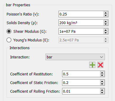

- In the Creator Tree, right-click Bulk Material and select Add Bulk Material.
- Rename the material to bar.
- In the Creator Tree, set the Solids Density property to 200 kg/m3 and the Shear Modulus to 1e7 Pa.
Click
below Interaction to define the interaction properties for collisions among the bar shaped particles. In the dialog, click OK.
Set the interaction coefficients as shown in the figure below.

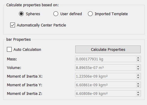

Note: When defining non-spherical shapes, you need to make sure that the principal axis of the particle is aligned with the x-axis, as shown in the figure below. The principal axis definition for some standard shapes is explained later in this tutorial.Figure 6.
In the Creator Tree, click Calculate Properties.
Figure 7.
Note: Since the "Automatically Center Particle" option is active, EDEM will internally adjust the positions of the spheres in the particle. Although you might see minor changes in the location of the spheres, the overall dimensions of the particle stay the same. - Right-click Bulk Material and select Add Bulk Material.

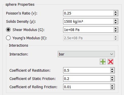

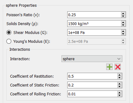

- Rename the material to sphere.
- Set the Solids Density property to 1500 kg/m3.
Click
below Interaction to define the interaction properties for collisions with sphere particles. In the dialog, select sphere and then click OK.
Figure 8.

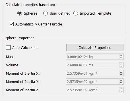

- In the Creator Tree, right click sphere and select .
- Rename the particle to sphere.
- Under bar, click Properties.
In the sphere Spheres panel, set the Physical Radius of the sphere to
0.004 m and then press Enter.
Figure 10.
Figure 11.

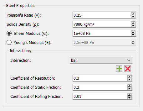

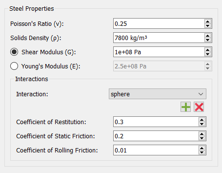

- Right-click Equipment Material and select Add Equipment Material.
- Rename the material to Steel.
- Set the Solids Density property to 7800 kg/m3.
Click
below Interaction to define the interaction properties for collisions with bar particles. In the dialog, select bar and then click OK.
Figure 12.
Click
again to define the interaction properties for collisions with sphere particles. In the dialog, select sphere and then click OK.

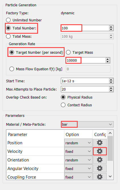

- Right-click factory and select Add Factory. Name it bar factory.
Set the particle generation parameters as shown in the figure below.
Figure 15.
Click
besides Velocity, set the Z-velocity to -1 m/s, and then click OK.
- Repeat steps 8-10 to create another factory named sphere factory. Use the same parameters but set the Total Number to 200 and the Material to sphere.

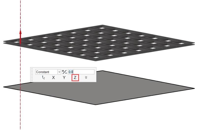

- Click Vector on the guide bar.
- Click anywhere on the sieve surfaces in the modeling window.
In the microdialog, click Z to
align the axis to the global z axis.
Figure 36.

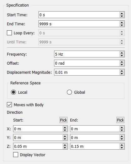

In the new plot dialog, click the drop-down beside the table icon for function
specification and select the oscillating option.
Figure 38.
Enter the values for the sine function as shown in the figure below.
Figure 39.
Click Convert to transform the sine function into an
array for the multiplier function.
The motion profile for the translation motion should look like the one shown below.
Figure 40.
