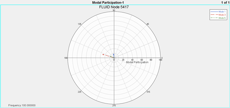

- Use the file browser button to open the modal_participation.f06 file, located in the plotting folder.
- Leave the Subcase: field set to Subcase 11.
- Leave the Data Type: field set to Frequency.
- From the Type: column, select Modal Participation.
- From the Request: column, select FLUID Node 5417.
- From the Component: column, select Mode 1, Mode 3 and Mode 5.
Click Apply to create the polar plots.
The vectors are plotted at a frequency of 100.0Hz.
Figure 3.

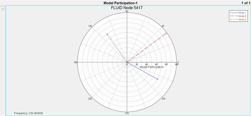

- Access the Frequency dialog by clicking the listed frequency value in the bottom left region of the plot area.
Select the 128.0Hz frequency and click
OK.
The vectors are plotted at 128Hz frequency.
Figure 4.

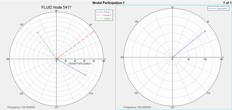

- Access the Frequency dialog by clicking the listed frequency value in the bottom left region of the right hand side of window 2.
Choose the 128.0Hz frequency and click
OK.
The summation vector is now plotted at 128Hz frequency.
Figure 5.

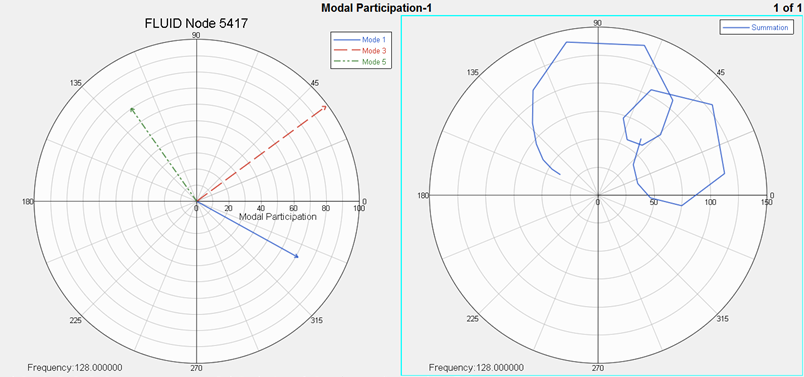

Change the Type: field to Phase vs Mag.
Notice: A Phase vs Magnitude curve for all frequencies is shown as a line connecting the tips of the vectors at different frequencies.
Figure 6.
