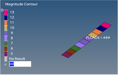

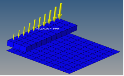

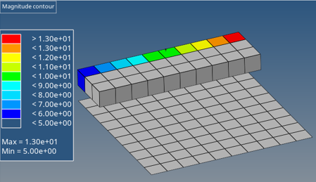

Load Visualization
Load plotting allows for visualization of distributed load values on an FE region. Different plotting types provide different views of the load.
  • Vector Plots – display value distribution with the direction of the load
    1.
  • Advanced Contour Plots – display value distribution with interactive filters
    2.
  • Contour Plots – display value distribution with respect to the entire model
    3.
Vector plot and contour options are available to visualize LOADADD (OptiStruct) and LOAD (Nastran) by right-clicking and selecting Visualize Loads from the コンテキストメニュー.
4.
Load values can be plotted at specific time stamps for curve-based time dependent loads.

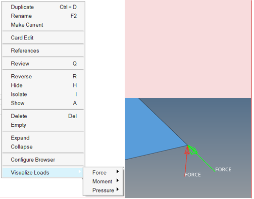

Load Configurations
Load entities have an associated load configuration. A load configuration determines how to draw, store, and work with a load.
