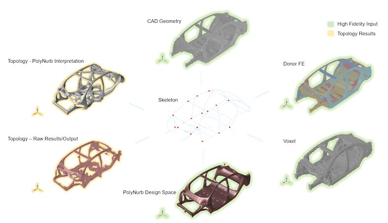

A skeleton model can be derived from several different sources. The most common sources are donor FE and CAD geometry. All the sources shown in 図 1 are supported, including direct interpretation from topology results.
