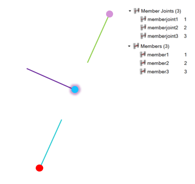

2. . Original model containing overlapping joints

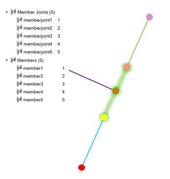

3. . Post equivalence the overlapping joints are consolidated

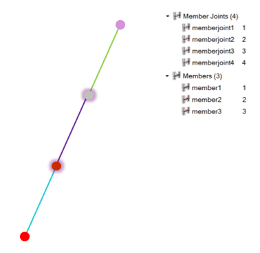

4. . Original model containing three joints located in the center of the members. If “Allow member destruction” is active, the central members are removed.
5. . Post equivalence the joints are consolidated, and the two members are removed
