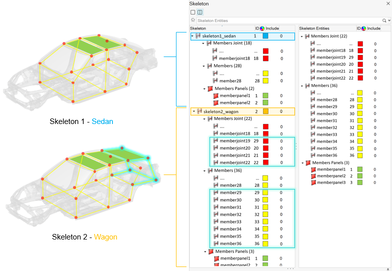

Use the Skeleton Browser to manage and run skeleton entities.
From the Skeleton ribbon, click the Skeleton tool.図 1.
The browser provides two views – single pane for single variant, dual pane for managing
multiple variants.
Variants are created by dragging and dropping from the main pane (right) to the secondary
(left). Depending on what is selected, the appropriate entities are organized. For
example, if a panel is organized to a new skeleton variant, then the members and member
joints are organized too. Organizing a member will organize the two joints too.
The difference between the Wagon and Sedan variants are highlighted in blue.図 2.
