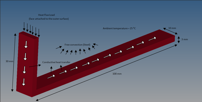

An extended surface heat transfer fin made of steel is illustrated in Figure 1. To meet certain structural design requirements, the fin is bent at 90° at approximately a quarter of its length.

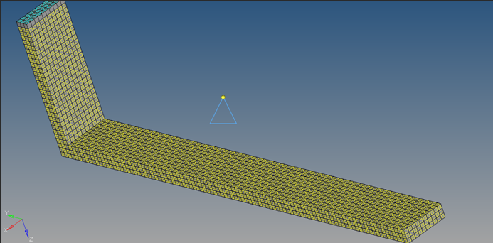

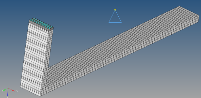

Figure 2. Heat Exchanger Fin Model for Transient Heat Transfer Analysis

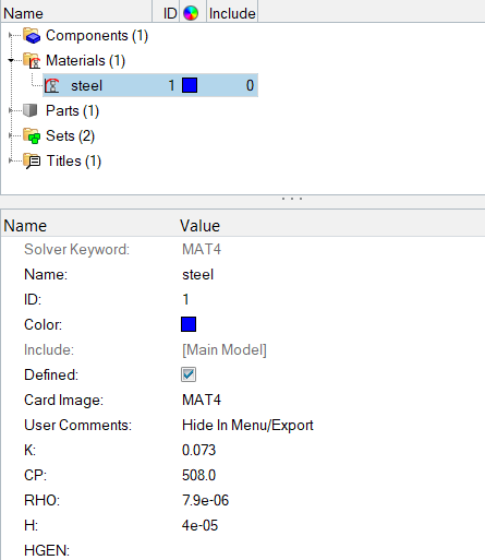

Create Thermal Material and Property
In the Model Browser, right-click and select .
A default MAT1 material displays in the Entity Editor.
- For Name, enter steel.
- For Card Image, select MAT4 and click Yes to confirm.
Enter the following material property values for the MAT4
Data Entry.
- [K] Thermal Conductivity
- 7.3 x 10-2W/mm °C
- [CP] Heat Capacity at constant pressure
- 508J/Kg °C
- [RHO] Density of the material
- 7.9 x 10-6Kg/mm3
- [H] Coefficient of heat transfer
- 4 x 10-5W/mm2°C
Figure 3.
Since you are conducting a purely heat transfer analysis, structural isotropic properties (for example, MAT1 card) are not required. Also, it is assumed that the thermal material properties (MAT4) are temperature independent.
A new material, steel, is created with thermal properties necessary for a transient heat transfer analysis.

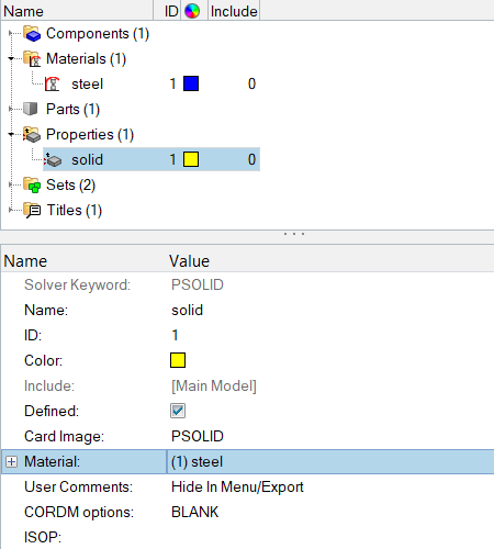

Now, create the solid property for this model referencing the PSOLID entry and connect the material, steel, to this property; the property can then be assigned to the existing component.
A default PSHELL property displays in the Entity Editor.
- For Name, enter solid.
- For Card Image, select PSOLID and click Yes to confirm.
- For Material, click .
In the Select Material dialog, select
steel and click OK.
Figure 4.

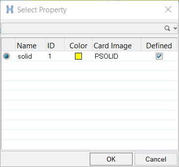

Link Thermal Material and Property to the Structure
click the component auto1.
The Entity Editor opens.
- For Property, click .
In the Select Property
dialog, select solid and
click OK.
The material steel now is automatically linked to the component auto1.
Figure 5.

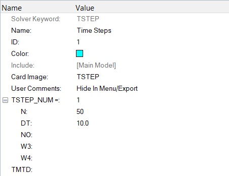

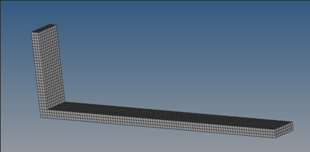

Create Transient Heat Transfer Analysis Time Steps
- In the Model Browser, right-click and select .
- For Name, enter Time Steps.
- For Card Image, select TSTEP.
- For TSTEP_NUM, enter a value of 1.
For N, enter the number of time steps 50 and for DT, set
each time increment to 10.0.
This encompasses a total time period of 500 seconds in which to capture the behavior of the system.
Figure 6.
- Click Close.

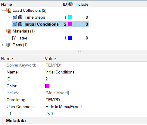

Create Transient Heat Transfer Analysis Initial Conditions
- For Name, enter Initial Conditions.
- For Card Image, select TEMPD.
For T1, enter a value of
25.
Figure 7.

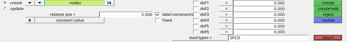

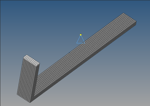

- Next, create the amplitude (constant part) of the time variant ambient temperature using an SPCD Data Entry. Click .
The ambient temperature is set by using the SPCD Data Entry

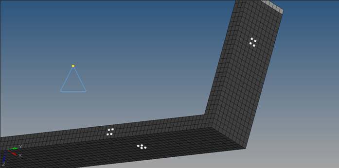

to control an existing node outside the actual structure. In the Constraints
panel, click , enter 5672 in the id= field and press
Enter.
The ambient node is highlighted in the Entity Editor above the structure.
- In the size= field, enter 5.0.
- Uncheck the boxes beside all the degrees of freedom (dof1 through dof6) and enter 0.0 in all the fields next to the dof#.
For load types =, select SPCD.
Figure 9. Creating an SPCD Entry to Control the Ambient Temperature
Click create/edit and enter 25.0
in the D field on the SPCD Data Entry.
This creates an SPCD referencing the ambient node specifying a temperature of 25°C.
- Click return twice to go back to the Analysis page.

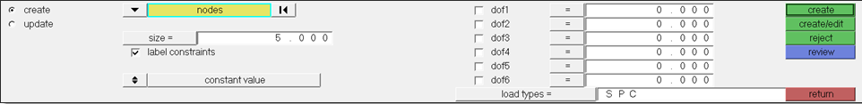

All entities referenced by SPCD entries should also be constrained by SPC data entries. The value of the corresponding SPC referencing an ambient point controlled via an SPCD by TLOAD1/2 entries should be equal to zero (0.0).
- Create a new load collector named Ambient SPC.
- For Card Image, select None.
- Make sure that the newly created load collector Ambient SPC is current and click nodes in the Constraints panel. and click
Select by id from the extended menu, enter
5672 and press Enter.
The ambient node is highlighted in the modeling window above the structure.
For load types =, select SPC.
Figure 11. Creating the SPC Boundary Condition

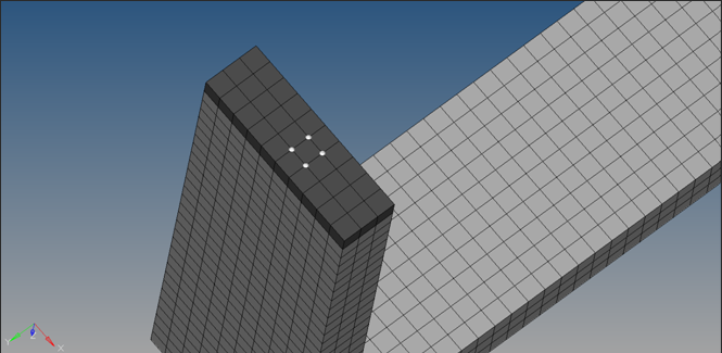

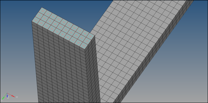

- An interface is now created between the heat flux source and the solid elements on the surface of the fin. This is done by clicking Create group dialog. and specifying conduction_interface in the Name field of the
- For Card Image, select CONDUCTION from the drop-down menu and click Yes to confirm.
For Secondary Entity IDs, click on the yellow Elements panel.
A panel appears under the modeling window.
- Click on the switch button beside elems and select faces from the list.
- Click the highlighted solid elems and select by sets from the selection menu.
Check the box next to Element_set_Flux and
click select.
The predefined element set is now highlighted in white on the model.
Figure 13. Highlighted Element Set is Displayed in White
Tip: The break angle helps find adjacent solid faces for the same element set; however, since this surface element set generation requires only one face, the value of the break angle is not germane in this situation. -
Click nodes and select
the nodes in the Figure 14.
Figure 14. Select the Nodes on the Highlighted Surface for Conduction Surface Element Creation
- Click add and return to go back to the Create group dialog.
Click Close.
A conduction interface is created because QBDY1 data can only reference surface elements and the conduction interface helps us create a set of surface elements at the surface where heat flux is input.
Figure 15. Newly Generated Surface Elements are Displayed in Blue -

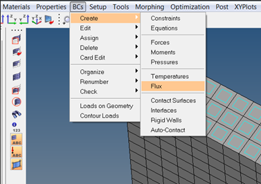

Next, create the amplitude (constant part) of the time variant heat flux using a
QBDY1 Data Entry. Do this by clicking on .
Figure 16. Access the Flux Creation Panel

Figure 19. Highlighted Element Set is Displayed in White
Click nodes next to face nodes, this highlights the same element
set in black. Click any four nodes on all highlighted faces of the model as shown in Figure 20 and Figure 21 and specify a break angle of 89°.
Tip: The break angle helps find adjacent solid faces for the same element set, all adjacent faces with the angle between surface normals less than the specified break angle are selected for surface element creation.
- Click add and return to go back to the Analysis page.
Click the MID field and
select steel from the
menu.
Figure 20. Select the Nodes on Four of the Seven Highlighted Surfaces for Convection Surface Element Creation
Figure 21. Select Nodes on the Three Remaining Highlighted Surfaces for the Creation of a Convection Interface

- As only a simple linear addition of the two TLOAD1 entries are required, for Dload_num, enter 2 and press Enter.
Click
next to Data below the Dload num field.
- In the Dload num pop-up window, enter S(1) = 1.0 and S(2) = 1.0.
- For L(1), select Ambient SPCD TLOAD1 from the menu and for L(2), select Heat Flux TLOAD1 from the menu.
Click Close.

- For TSTEP, select Time Steps.

- Under SUBCASE OPTIONS, for IC, select Initial Conditions.

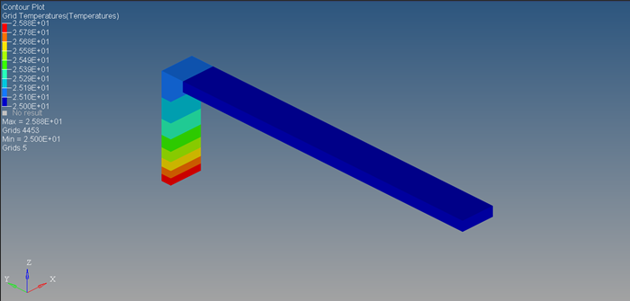

View Results
From the OptiStruct panel, click HyperView.
HyperView is launched and the results are loaded. A message window appears to inform of the successful model and result files loading into HyperView.
- Click Close to close the message window, if one appears.

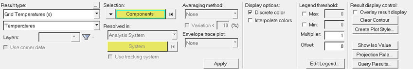

On the Results toolbar, click
to open the Contour panel.
Select the first pull-down menu below Result type and select Grid
Temperatures(s).
Figure 25. Contour Plot Panel in HyperView

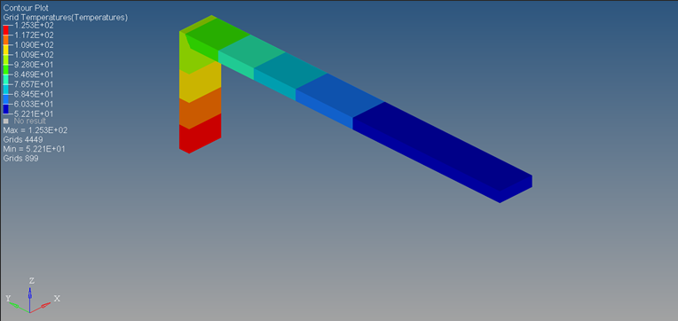

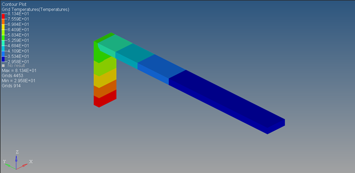

Click Apply, select Time =
5.0000000E+02 from the Results Browser.
A contour plot of grid temperatures at the final time step is created as shown in Figure 26.
Figure 26. Grid Temperature Contour for the Final Time Step (500 seconds) - WITH FREE CONVECTION
Checkpoint
In Figure 26, this is the grid point temperature plot after 500 seconds. The system is input a linearly increasing heat flux from 0 to 0.1 W/mm2 from 0 to 500 seconds respectively. Therefore, a physical correlation can be the effect of starting an IC engine to full capacity wherein the flux transmitted to the outer surface linearly increases with time. Note that the flux patterns in actuality may be different and may fluctuate based on the duration of the power cycles. The maximum temperature of 81.3°C predictably occurs at the elements closest to the heat flux loading site and the minimum temperature of 29.5°C occurs at elements farthest from the heat source.
2.0000000E+01 from the Results Browser.
A contour plot of grid temperatures is created, as shown in Figure 27.
Figure 27. Grid Temperature Contour Plot after 20 Seconds - WITH FREE CONVECTION

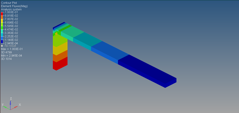

- Select the first pull-down menu below Result type and select Element Fluxes (V).
- Click Apply, select Time = 5.0000000E+02 from the Results Browser to view the element flux results after 500 seconds in Figure 29.
