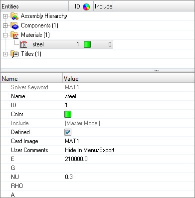

Create the Material
In the Model Browser, right-click and select from the context menu.
A default material displays in the Entity Editor.
- For Name, enter steel.
- Set Card Image to MAT1.
Enter the material values next to the corresponding fields.
- For E (Young's Modulus), enter 2.1E+05.
- For NU, (Poisson's Ratio), enter 0.3.
- For RHO (Mass Density), leave it undefined since only a static analysis is performed.
Figure 1. Material Property Values for steel
A new material, steel, has been created. The material uses OptiStruct's linear isotropic material model, MAT1. - Click Close.

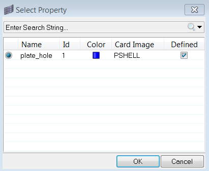

Update the plate_hole Component
In the Model Browser, click on the component plate_hole.
The component fields are displayed in the Entity Editor below.
For Property, click Select Property dialog, select
plate_hole and click OK.
. In the

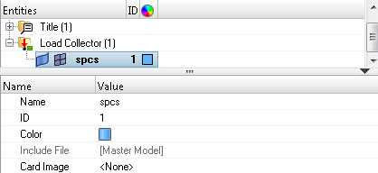

A default load collector displays in the Entity Editor.
- For Name, enter spcs.
- Click Color and select a color from the color palette.
Set Card Image to None and click
Close.
A new load collector, spcs is created.
Figure 4. Creating the spcs Load Collector

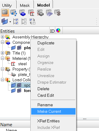

In the Model Browser, Load Collectors folder, right-click
on spcs and select Make Current to
set spcs as the current load collector.
Figure 5. Setting spcs as the Current Load Collector

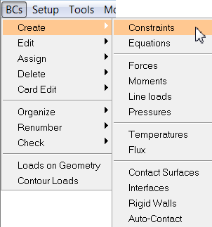

From the menu bar, click to open the Constraints panel.
Figure 6. Accessing the Constraints Panel

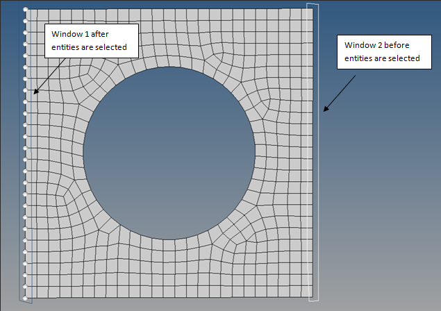

Make sure nodes is selected from the entity selection
switch.
Figure 7. Menu after Clicking on the Entity Selection Switch

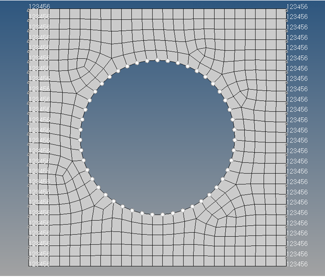

Hold Shift while clicking-and-dragging your mouse to
select the nodes on the two ends of the plate.
Figure 8. Nodes to Select for the Constraints

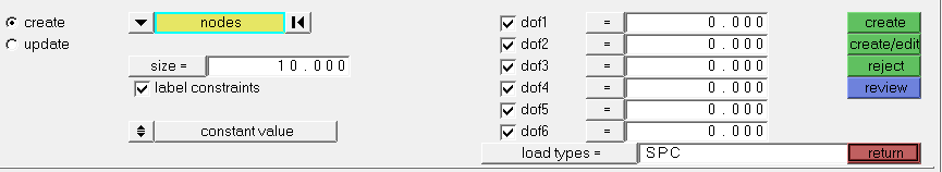

Constrain dof1, dof2,
dof3, dof4,
dof5, and dof6 and set all of
them to a value of 0.0.
- DOFs with a check will be constrained while DOFs without a check will be free.
- DOFs 1, 2, and 3 are x, y, and z translation degrees of freedom.
- DOFs 4, 5, and 6 are x, y, and z rotational degrees of freedom.
Figure 9. Constraining all Degrees of Freedom of the Selected Nodes
Click create.
Constraints are applied to the selected nodes.
select the nodes around the hole.
Figure 11. Nodes Selected for the Application of Loads around the Hole

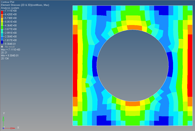

View a Contour Plot of Stresses
From the OptiStruct panel, click HyperView.
HyperView is launched and the results are loaded. A message window appears to inform of the successful model and result files loading into HyperView.
On the Results toolbar, click
to open the Contour panel.
Define settings in the Contour panel.
- Under Result type set the first first pull-down menu to Element Stresses (2D & 3D) (t) and set the second pull-down menu to vonMises.
- Set the Averaging method to None.
Figure 15. The Contour panel
Click Apply.
A contoured image representing von Mises stresses should be visible. Each element in the model is assigned a legend color, indicating the von Mises stress value for that element, resulting from the applied loads and boundary conditions.
In the View Controls toolbar, click the XY Top Plane
View icon to change the view the model.
Figure 16. The von Mises Stress Plot for the Given Subcase
- What is the maximum von Mises stress value?
- At what location does the model have its maximum stress?
- Does this make sense based on the boundary conditions applied to the model?
