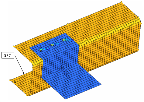

OS-T: 1110 Modal Analysis Setup
In this tutorial, you continue to gain an understanding of the basic concepts for creating a OptiStruct input file. More specifically, learn how to set up a model for modal analysis, specify solver specific controls and also submit an input file to the solver from HyperMesh.
Before you begin, copy the file(s) used in this tutorial to your working directory.
  • channel_brkt_modal.hm
To complete the setup of the model for a modal analysis with OptiStruct, you need to define a normal modes SUBCASE, containing METHOD and SPC statements.

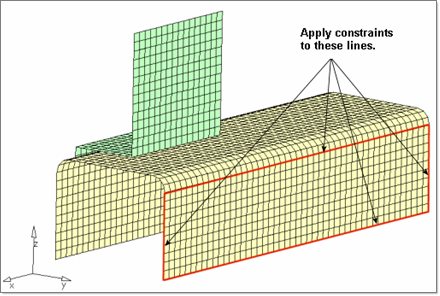

Apply Constraints (OptiStruct SPC) on the Channel
  1. Expand the Component folder in the Model Browser.
  2. Click the geometry icon entityGeometry-24 next to the channel component to turn the geometry display on.
  3. Click the Isometric View icon viewAxisOrientationIso-24 in the toolbar.
    You are going to create the SPC constraints on the nodes along the lines on the perimeter of the channel's bottom surface, as shown in the image below.
    Figure 3. Apply Constraints on the Channel
    rd1110-02
  4. Click BCs > Create > Constraints to open the Constraints panel.
  5. Switch the entity selector to lines.
  6. Select the six lines on the perimeter of the channel's bottom surface.
    To view the selected lines clearly, switch to Transparent Elements mode, as shown below:
    Figure 4.
    rd1110_transparent
  7. Activate degrees of freedom (DOF) 1 through 6.
    • DOFs with a check will be constrained while DOFs without a check will be free.
    • DOFs 1, 2, and 3 are x, y, and z translation degrees of freedom.
    • DOFs 4, 5, and 6 are x, y, and z rotational degrees of freedom.
  8. For size =, enter 10.
    The display size of the constraints is reduced.
  9. Click create > return to exit the panel.
