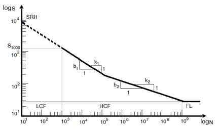

Figure 3. Two Segment S-N Curve

- MATFAT
- Defines the material properties for the fatigue analysis. These properties should be obtained from the material's S-N curve (Figure 3). The S-N curve, typically, is obtained from completely reversed bending on mirror polished specimen. S-N curves can be one segment or two segments.

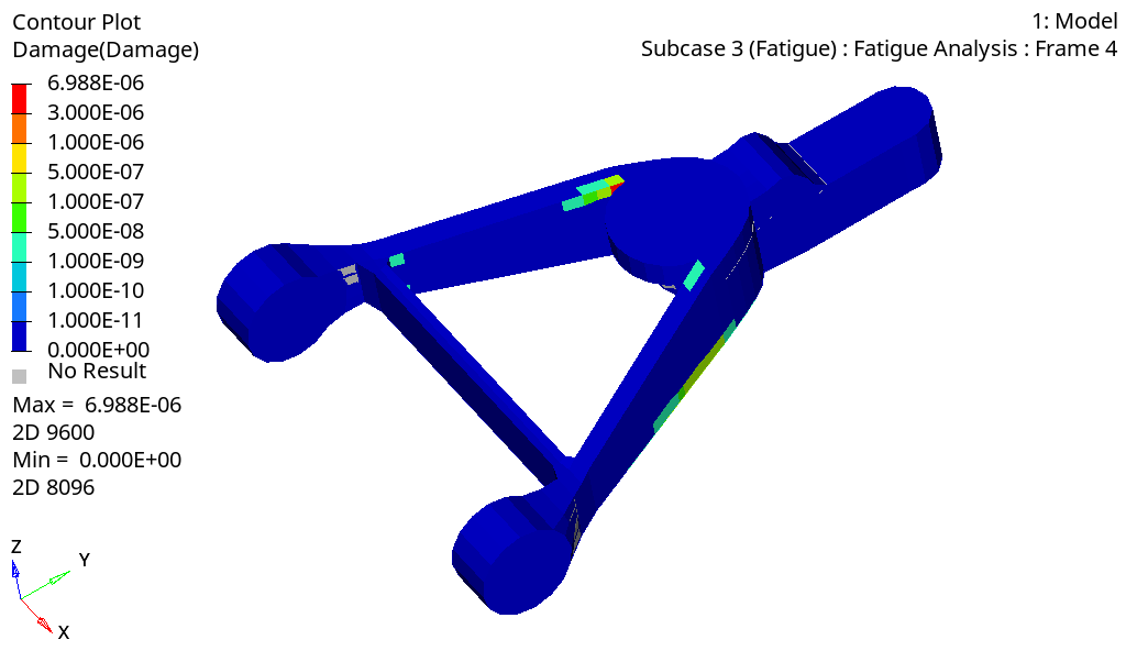

Review the Results
- When the analysis process completes, click HyperView to launch the results.
- In the Results tab, select Subcase 3 (Fatigue) from the subcase field.
On the Results toolbar, click
to open the Contour panel.
Set Result type to Damage and click
Apply to contour the elements.
Figure 11. Elemental Damage Results
