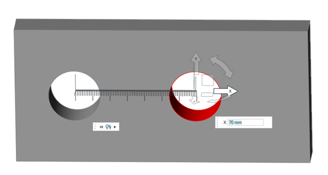

Copy Features
Copy holes, pockets, and surface features.
On the Geometry ribbon, select the Move
Faces tool.
Note: The tool may be hidden in the dropdown menu. To access the dropdown menu, you can do one of the following:- Select
at the lower right corner of the currently displayed tool.
- Click and hold the currently displayed tool.
Tip: To find and open a tool, press Ctrl+F. For more information, see Find and Search for Tools. - Select
- Select the features to copy.
Select the
icon on the microdialog, then use the graphic manipulator to position the copy.
Figure 1. Copying and Moving a Feature
Click Apply
on the microdialog.

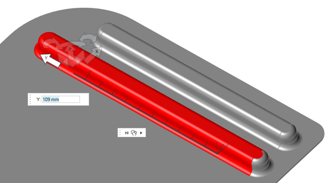

Extend Features
Extend holes, pockets, and surface features that include multiple faces.
Faces tool.
- Select the faces to extend.
Drag an arrow on the graphic manipulator to extend the feature.
Figure 2. Extending a Feature
Click Apply
on the microdialog.
