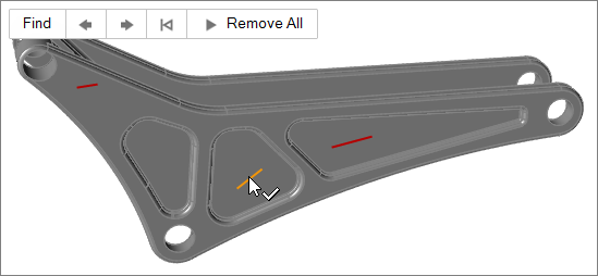

Remove Imprints
Find and remove imprints from a model. An imprint is an edge or a point that appears on a surface that can be removed without changing the underlying integrity of the surface, such as scratches or trimmed points.
On the Geometry ribbon, select the tool.
Note: The tool may be hidden in the dropdown menu. To access the dropdown menu, you can do one of the following:- Select
at the lower right corner of the currently displayed tool.
- Click and hold the currently displayed tool.
Tip: To find and open a tool, press Ctrl+F. For more information, see Find and Search for Tools.By default, all of the imprints in the model are selected and highlighted red. The total number of imprints found is displayed above the Imprints tool. - Select
Remove imprints.
- To remove all selected imprints, click Apply
on the guide bar.
- To remove an individual imprint, click a selected imprint.
Figure 1. Removing Imprints
- It is recommended that you remove imprints before applying other geometry simplification tools.
- To review each selected imprint located by the search, click
and
on the guide bar.
- Some geometry tools automatically detect relevant features when the tool is opened. You can disable this behavior in the Preferences under .

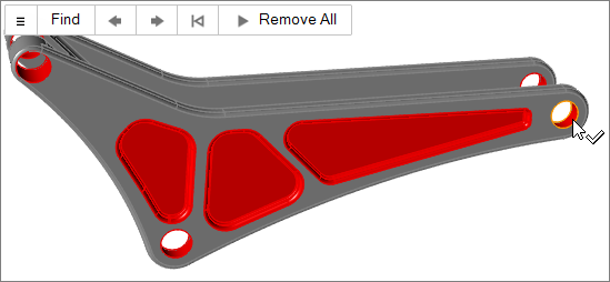

Remove Holes and Pockets
Find and remove holes and pockets, and find raised areas such as lettering.
The Holes tool allows you to select holes or pockets and find all that are larger, smaller, or similar (±5%) in size. It will also attempt to identify chains of connected holes or pockets by searching upward, toward the outer face.
Tip: To find and open a tool, press Ctrl+F. For more information, see Find and Search for Tools.By default, all of the holes in the model are selected and highlighted red. The total number of holes found is displayed above the Holes tool. - Select
- Optional:
On the guide bar, click
to define settings used to find and select holes of a specific size.
Remove holes.
- To remove all selected holes, click Apply
on the guide bar.
- To remove an individual hole, click a selected hole.
Figure 3. Removing Holes and Pockets
- To review each selected hole located by the search, click
and
on the guide bar. Clicking a selected circle removes it, and the view automatically zooms in on the next selected hole.
- If there are several contiguous holes or pockets, selecting an adjacent hole/pocket will add to the chain. When removing a hole or pocket that is part of a chain, the entire chain will be removed.
