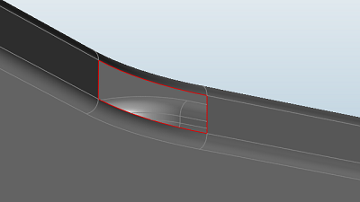

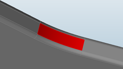

Close Holes: Examples
Example 1: Close Holes - Before |
Example 1: Close Holes - After |
