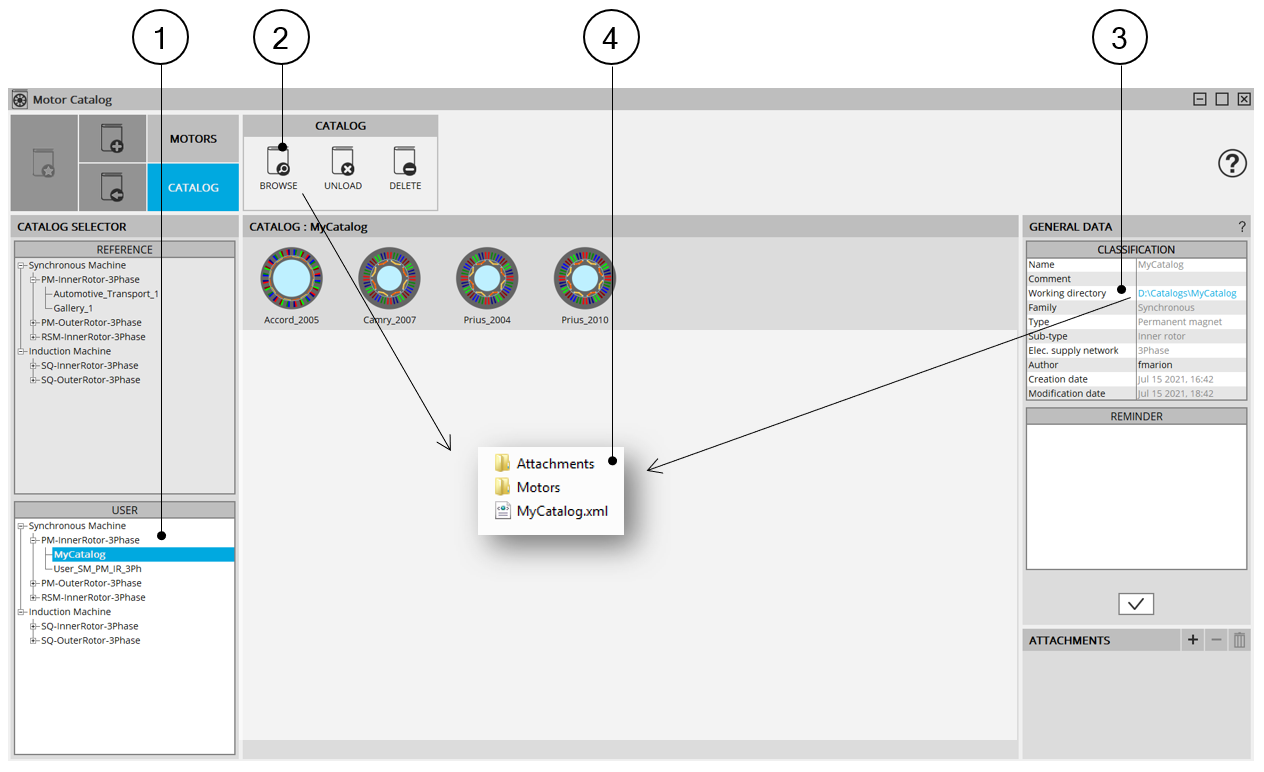

The contents of folder directly reachable from the CATALOG interface are described below.
| Browsing to access the catalog folder | |
| 1 | Selection of a user’s catalog. In our example the name of this catalog is “MyCatalog”. |
| 2 | Click on the icon “BROWSE” to reach the folders dealing with the motor. |
| 3 | Click on the path in the “Working folder” field to reach the folders dealing with the motor. |
| 4 | Content of the folder “MyCatalog”:Two folders “Attachments” and “Motors”
+ one xml file: MyCatalog.xml.See below the content of these folders. |

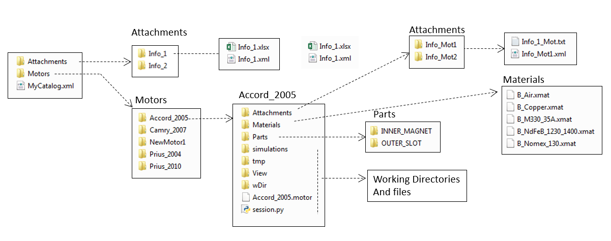

1.2 Folder organization
The graph below shows how to reach the main files dealing with catalogs or motors.
| Content of folders |
Folder “Attachments”:
All the documents associated to the considered catalog (or Motor).
Folder “Motors”:
All the motors stored in the considered catalog.
