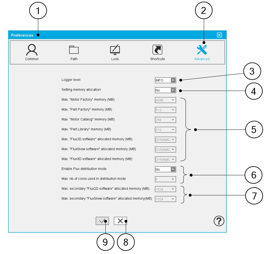

| Advanced Preferences Screen | |
| 1 | The Preferences dialog box is opened from the supervisor. |
| 2 | Fifth tab is Advanced Preferences. |
| 3 | Logger level: INFO, WARN, DEBUG Logger level represents the level of information given by log files provided by FluxMotor®. |
| 4 | Setting memory allocation: Yes / No. In case of answer “Yes” the maximum memory allocation for applications can be defined by user. |
| 5 |
Maximum memory allocation for applications. It is recommended to keep default values as far as possible. In case of a trouble consult our support team. These fields are in write mode in advanced FluxMotor® user level. |
| 6 |
Buttons to enable the Flux solver distribution mode. By default, this option is set to “No”. And to define the maximum number of cores used by the distribution (See note below) |
| 7 |
Maximum allocated memory for secondary Flux2D and FluxSkew software when
the Flux solver distribution mode is selected.
Note: Ony static allocated memory can be used. The dynamic memory
allocation is not available. |
| 8 | Button to close the Preferences dialog box without applying the changes. |
| 9 | Button to apply changes and close the Preferences dialog box. |

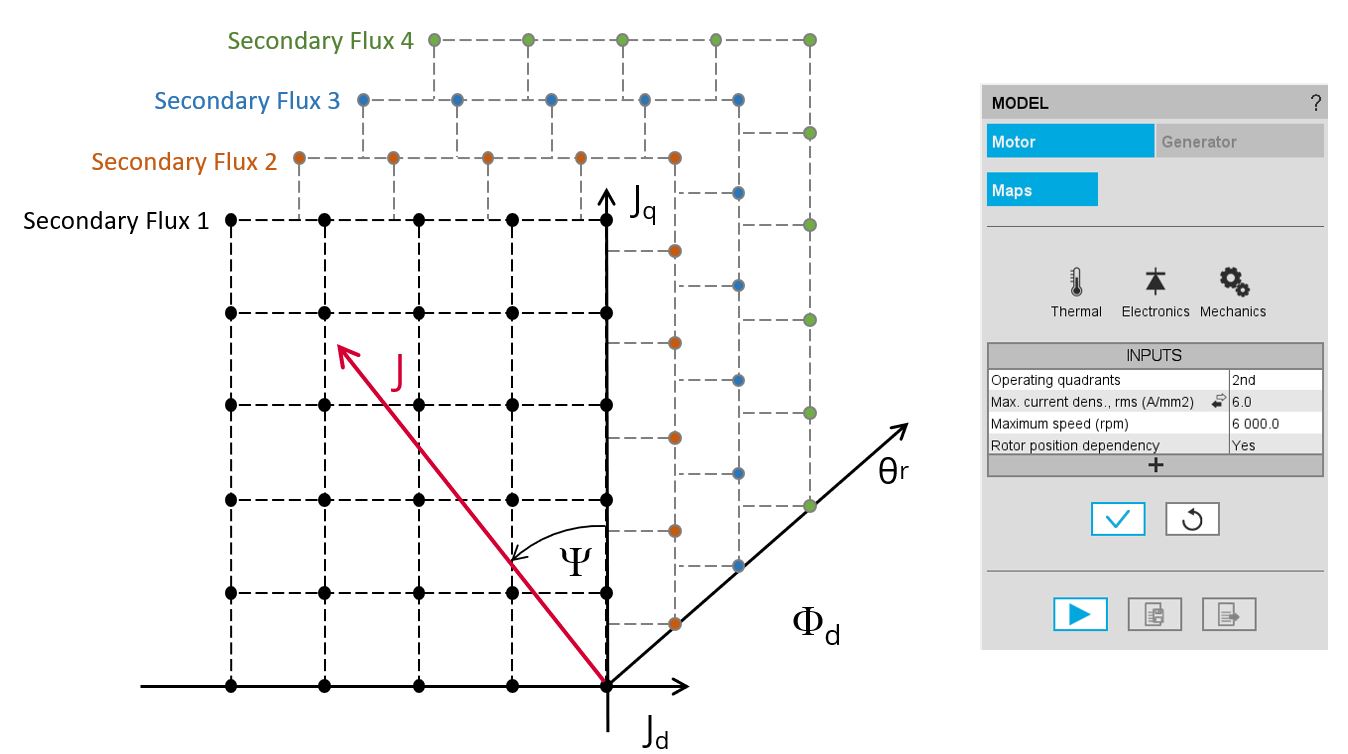

The “Flux distribution mode” allows the user to save computation time by parallelizing the finite element (FE) solving of a test.
Indeed, FE solving is done by parallelizing several independent configurations of a FE problem (such as the value of the stator current) instead of running them sequentially.

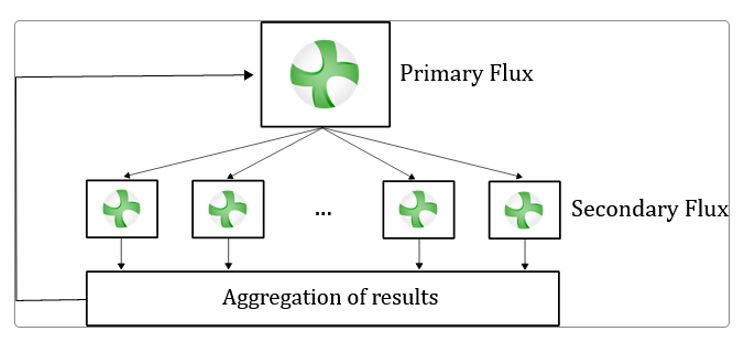

A primary Flux project is launched and controls all the other secondaries projects (distribution). The primary project oversees the gathering of all the results obtained during the solving process by all the sub-projects Flux as shown in the figure below:
| Flux distribution mode - Flux process operating principle |
When the Flux distribution mode is activated, FluxMotor automatically uses it and manages the number of cores used to reduce, as far as possible, the computation time.
Depending on the number of computation steps, FluxMotor will adapt the number of cores to have at least 10 steps to solve per core.
In other words, if you select a maximum number of 5 usable cores and solve a test with 25 computation steps ("Characterization - Model - Maps" test with an Id, Iq grid of 5x5), FluxMotor will only distribute the resolution over 2 cores, which is the best configuration according to the FE project to solve.

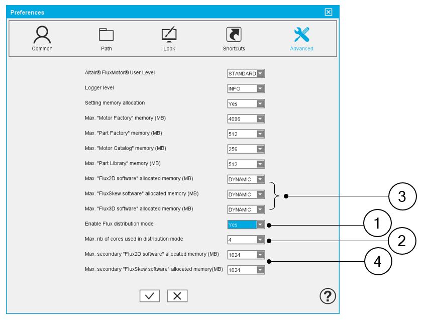

In FluxMotor, the Flux distribution mode (number of secondary Flux in parallel) must be set in the Preferences in the section Advanced. It’s just needed to set “Flux distribution mode” to “Yes” and to select the “Maximum number of cores” you want to use.
When using the distribution mode, the primary Flux can be used either with dynamic or static memory allocation. However, it is highly recommended to use the dynamic memory allocation.
When using the distribution mode, only the static memory can be used for the secondary Flux. The dynamic memory allocation is not available.
| Flux distribution mode | |
| 1 | Button to enable the Flux solver distribution mode. By default, this option is set to “No”. |
| 2 | Button to select the maximum number of cores used by the distribution |
| 3 | Button to set the maximum allocated memory for the primary Flux (Dynamic allocated memory is recommended) |
| 4 | Button to set the maximum allocated memory for the secondary Flux (Only static allocated memory can be selected) |

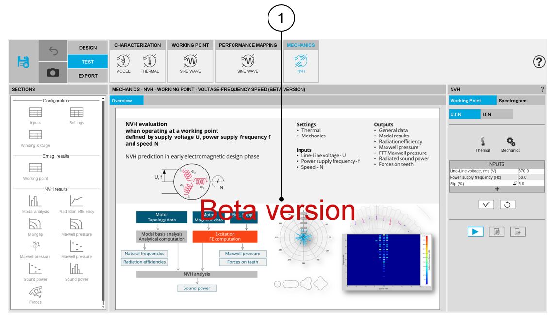

Warning - Beta version mode
Sometime, the non-entirely qualified feature like tests for instance, are nevertheless available for testing. In this case, a "Beta version" banner warns the user to be careful when analyzing the results.
For example, in the current version, evaluation of NVH for induction machines with squirrel cage is concerned by this mode.
| NVH evaluation is available with the beta user level mode | |
| 1 | Message “Beta version” is displayed for warning the users |
