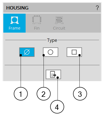

The tools available in the housing tab allow defining the frame topology.
Three choices are available to define this topology: None, Circular or Square.
By default, housing type is set to “None”. There is no frame.
Important note: When “None” is selected, accesses to External cooling and Internal cooling environments are locked.
1 |
Default setting : Housing type is « None » The machine has no frame. |
| 2 | Button to select a Circular shape frame. | |
| 3 | Button to select a Square shape frame. | |
| 4 | Icon to export frame data into *.txt or *.xls files. | |
| Frame type available | ||

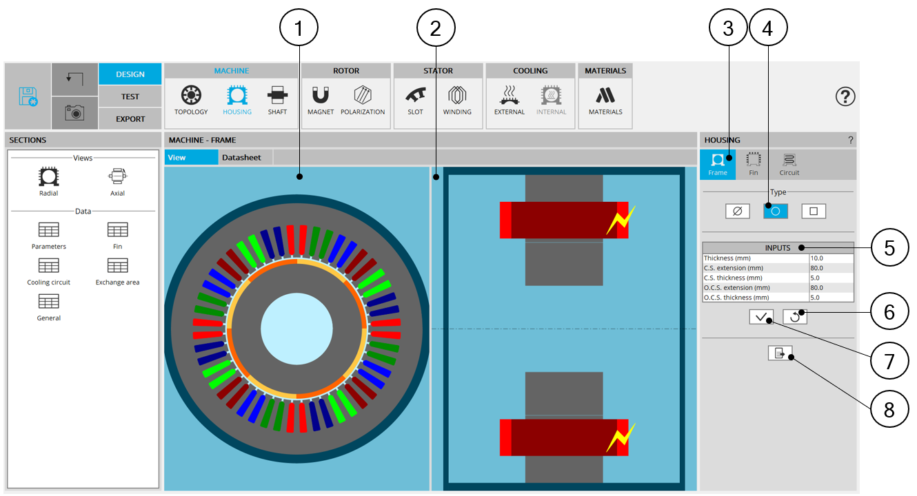

| Circular shape frame design area | |
| 1 | Radial view of the motor, including the housing topology and dimensions. |
| 2 | Axial view of the motor, including the housing topology and dimensions. |
| 3 | The section frame is selected to define the type and dimensions of the frame. |
| 4 | Selected button to set a circular shape frame. |
| 5 | User input parameters to define the frame dimensions. For more information see below. |
| 6 | Button to restore default input values. |
| 7 | Button to apply inputs. Pressing the enter key twice applies inputs too. |
| 8 | Icon to export frame data into *.txt or *.xls files |

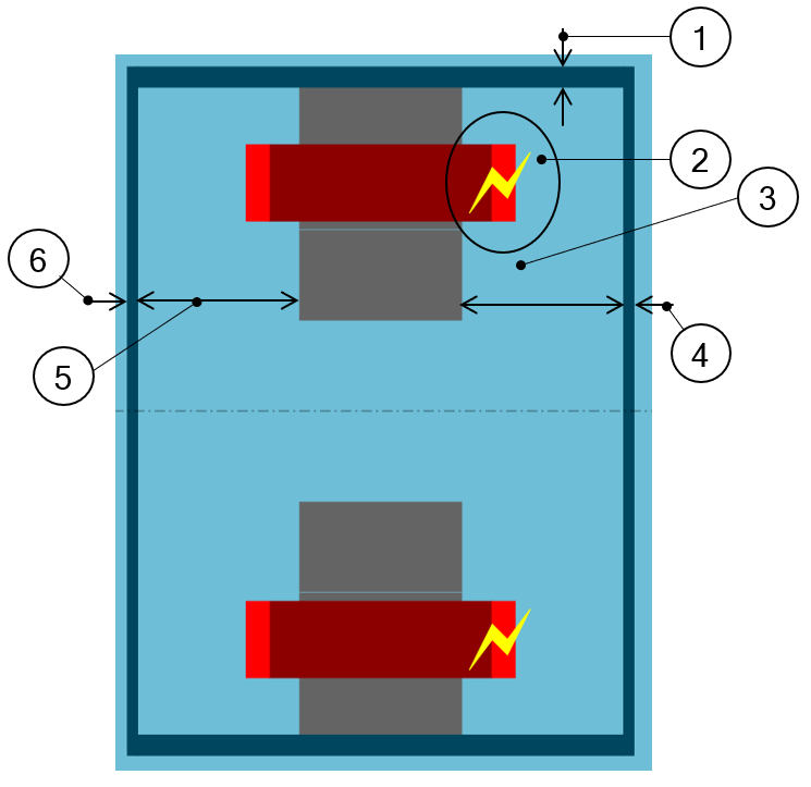

1 |
Thickness of the frame. Allowed range of values ]0, 50] mm. |
| 2 | Connection side (C.S.) is identified by yellow lightning. | |
| 3 |
Connection side extension. Allowed range of values [0, 20000] mm. |
| 4 |
Connection side – End-plate thickness. Allowed range of values [0, 50] mm. |
| 5 |
Opposite connection side extension. Allowed range of values [0, 20000] mm. |
| 6 |
Opposite connection side – End-plate thickness. Allowed range of values [0, 50] mm. |
| User input parameters to define frame dimensions in the axial view | ||

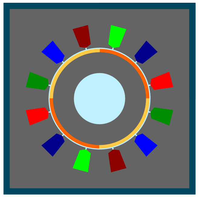

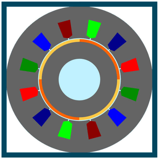

2. Combination between lamination outer shape and frame types
| Frame type | ||||
| None | Circular | Square | ||
Lamination Outer shape |
None | ν | ν | ν |
| Circular | ν | ν | ν | |
| Square | ν | Not possible | ν | |

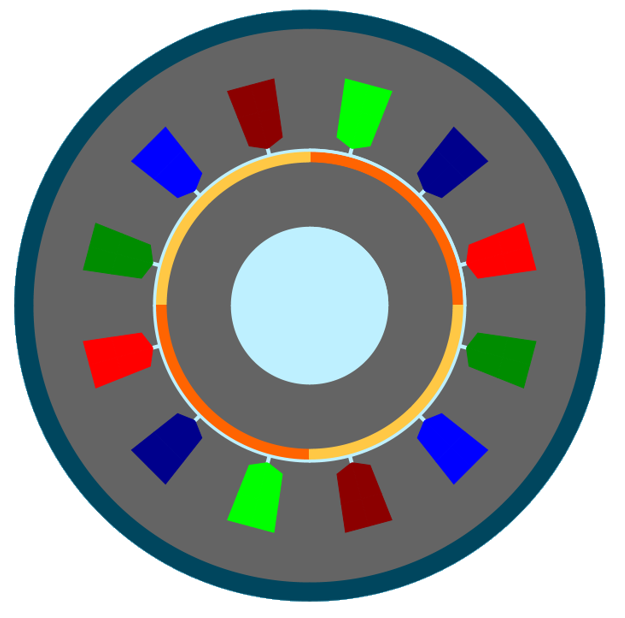

| Circular shape lamination & Circular shape frame | Circular shape lamination & Square shape frame | Square shape lamination & Square shape frame |
