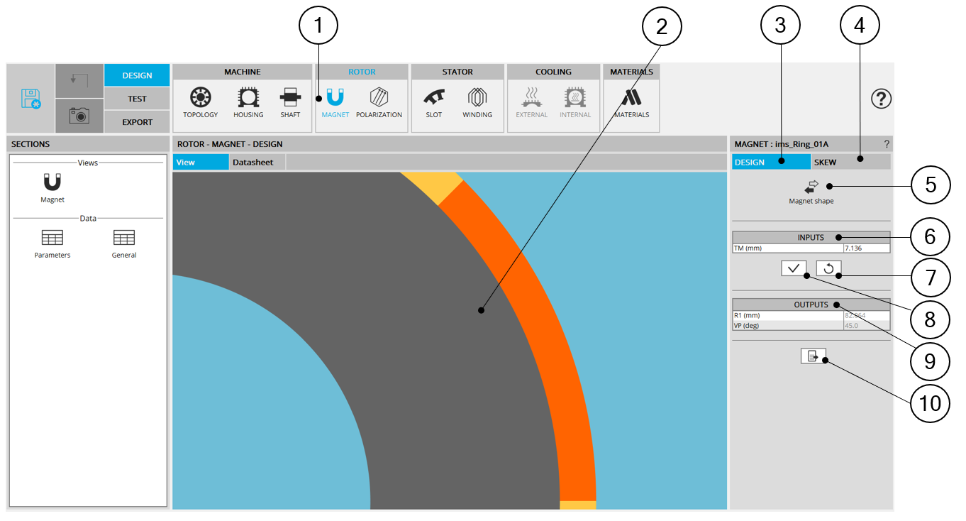

| MAGNET design area | |
| 1 | Selection of the ROTOR subset: MAGNET panel (Click on the icon MAGNET) |
| 2 | Visualization of the motor radial view to view the magnet topology and dimensions. |
| 3 | DESIGN tab indicates the tools to define the magnet topology and
parameter values. Note: By default, DESIGN tab is
selected |
| 4 | SKEW tab indicates the tools to define the rotor (magnet) skew angle |
| 5 | "Magnet shape" button allows accessing the magnet libraries to change
the magnet topology. See additional information below. |
| 6 | User input parameter fields to enter the values. |
| 7 | Button to restore default input values. |
| 8 | Button to apply inputs. Pressing the “enter key” twice applies inputs too. |
| 9 | Output parameters (read only data) to complete the description of the topology. |
| 10 | Icon to export magnet data into *.txt or *.xls files. |
