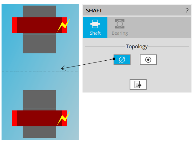

Two types of shaft can be selected:
None: No shaft represented in the rotor design.
It is replaced by a gas (like air).

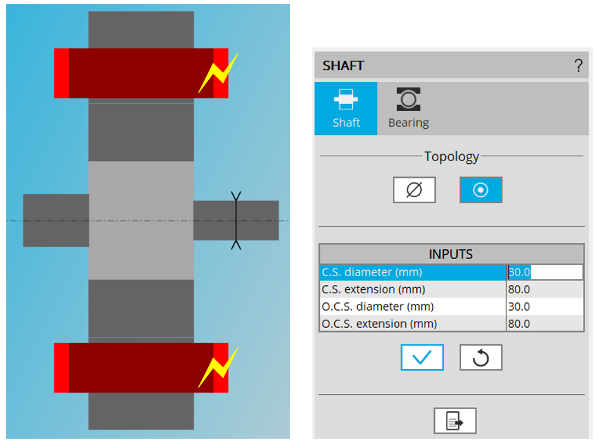

Solid: Shaft is represented and considered in the rotor design.
It is built with a solid material or laminations.
| Shaft type: None | Shaft type: Solid |

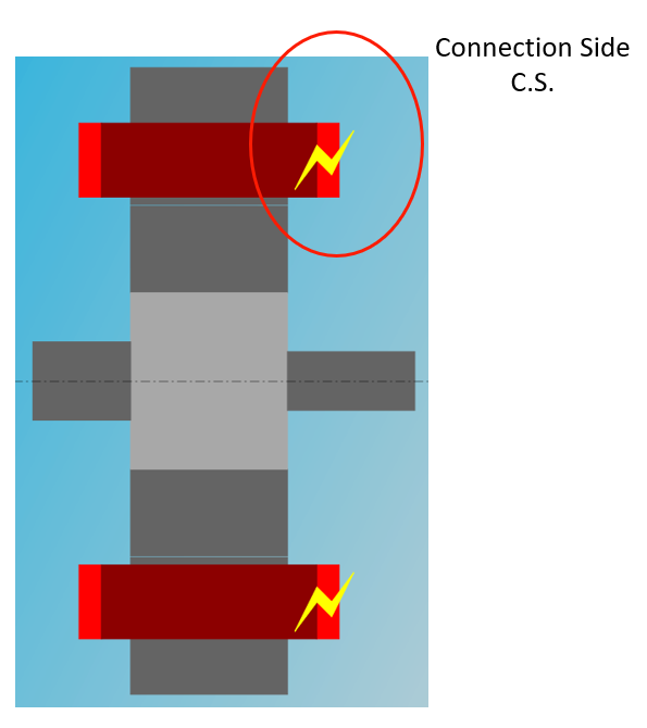

| Dimensions are illustrated with arrows | Connection side (C.S.) is identified by yellow lightning. |

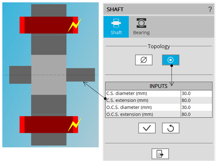

2. Shaft - Inputs
| Label | Symbol | Tooltip, note, formula |
| C.S. diameter | D1 | Connection side end-shaft diameter. |
| C.S. extension | L1 | Connection side end-shaft extension. |
| O.C.S. diameter | D2 | Opposite connection side end-shaft diameter. |
| O.C.S. extension | L2 | Opposite connection side end-shaft extension. |
