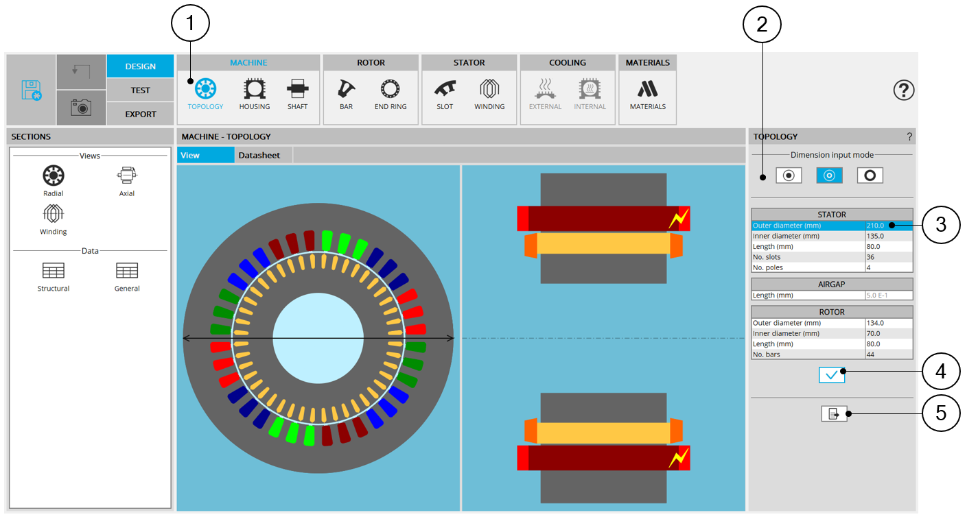

The first step of the design consists of defining structural data of the machine.
However, at any time, it is possible to reach and modify the structural data from the Motor Factory design environment.
Here is the process to reach and modify the structural data from the general data panel.
| Process to reach and modify the structural data | |
| 1 | Selection of the MACHINE subset: TOPOLOGY panel (Click on the icon TOPOLOGY) |
| 2 |
Choose a way to define the diameters of the machine and the airgap See additional information below. |
| 3 | Modify the values of the structural data – When selected, the corresponding arrow is displayed on the view |
| 4 | Button to apply inputs |
| 5 | Icon to export data into *.txt or *.xls files - Please see above illustration |
