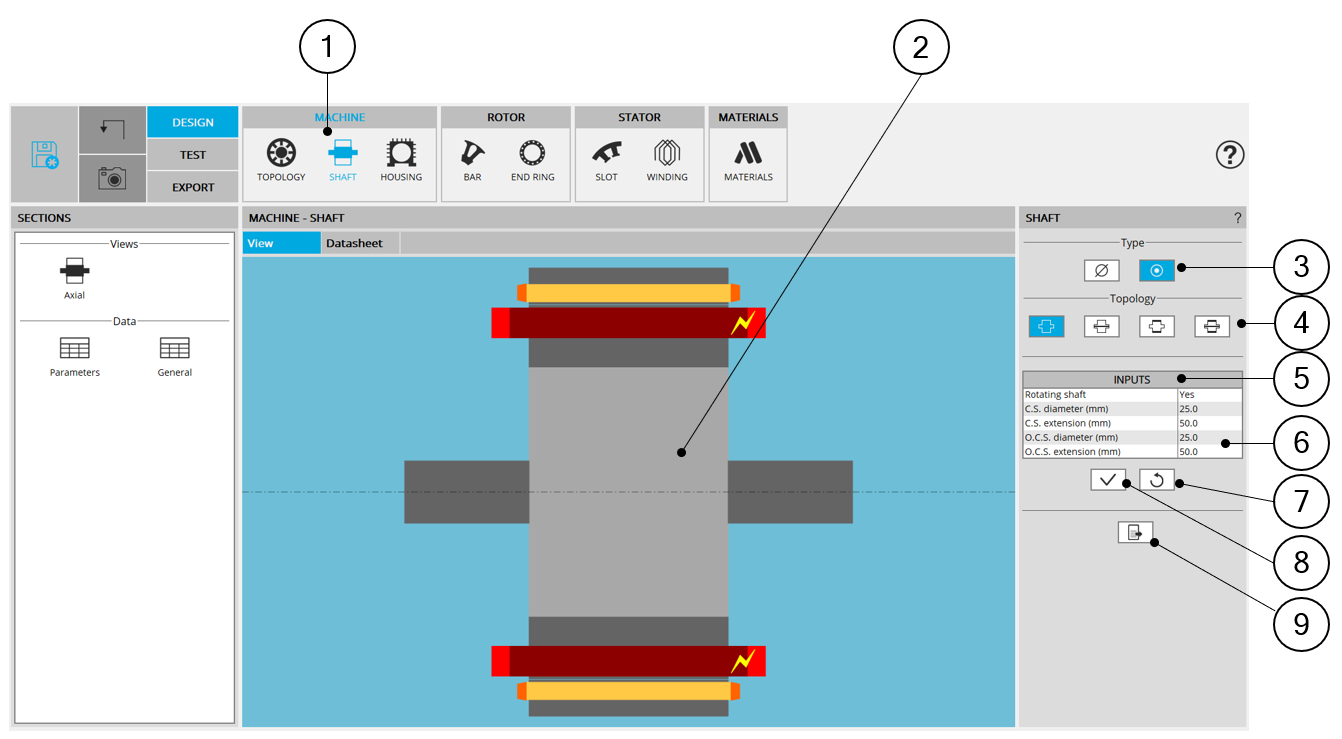

SHAFT
Overview
| SHAFT - design area | |
| 1 | Selection of the MACHINE subset: SHAFT panel (Click on the icon SHAFT) |
| 2 | Visualization of the motor axial view to visualize the shaft topology and dimensions. |
| 3 |
Choice of the shaft type. Two types are available:
Note: The connection side (C.S.) is identified by
yellow lightning.
Note: The range of definition for dimensions is [0,
20000] mm.
| 4 | Topology of the shaft must be defined:Solid, Solid with hollow, Solid with ring, Solid with hollow and ring |
| 5 | Shaft input data to be defined |
| 6 | If the shaft type is solid, the end-shaft must be defined. First
indicate if the shaft is rotating or not Note: Connection side (C.S.) is identified by yellow lightning Note: Range of definition for dimensions: [0, 20000]
mm. |
| 7 | Button to restore default input values. |
| 8 | Button to Apply inputs. Pressing the enter key twice applies inputs too. |
| 9 | Icon to export shaft data into *.txt or *.xls files. |
