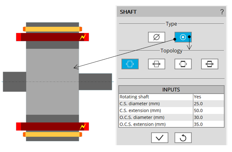

It is possible to consider a shaft or not:

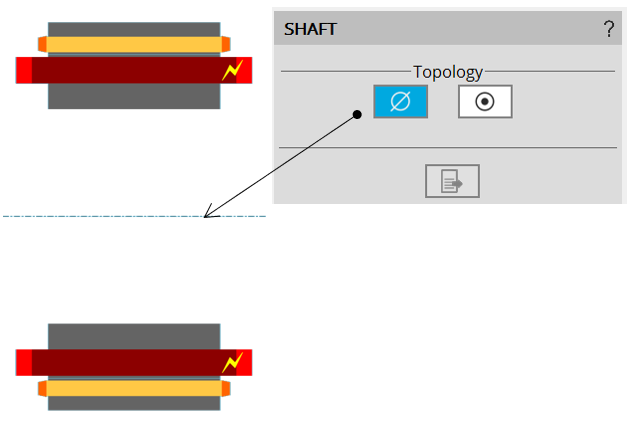

Type = None: No shaft represented in the rotor design. It is replaced by a fluid (like air).

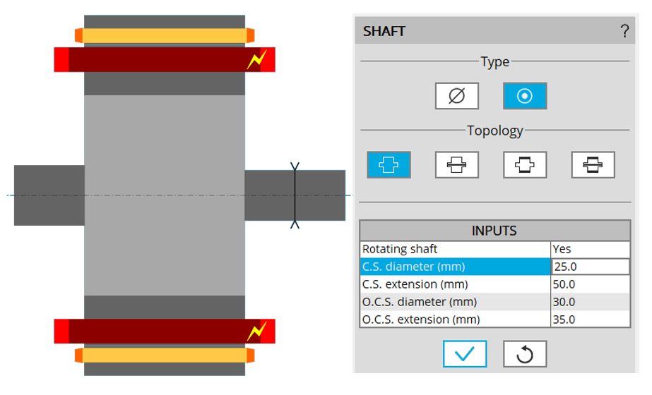

Type = Solid: 4 different topologies of shaft can be considered in the rotor design. It is built with a solid material or laminations. The four topologies are described below.
| Shaft type: None | Shaft type: Solid |

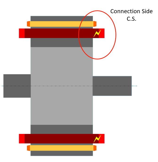

| Dimensions are illustrated with arrows | Connection side (C.S.) is identified by yellow lightning. |
