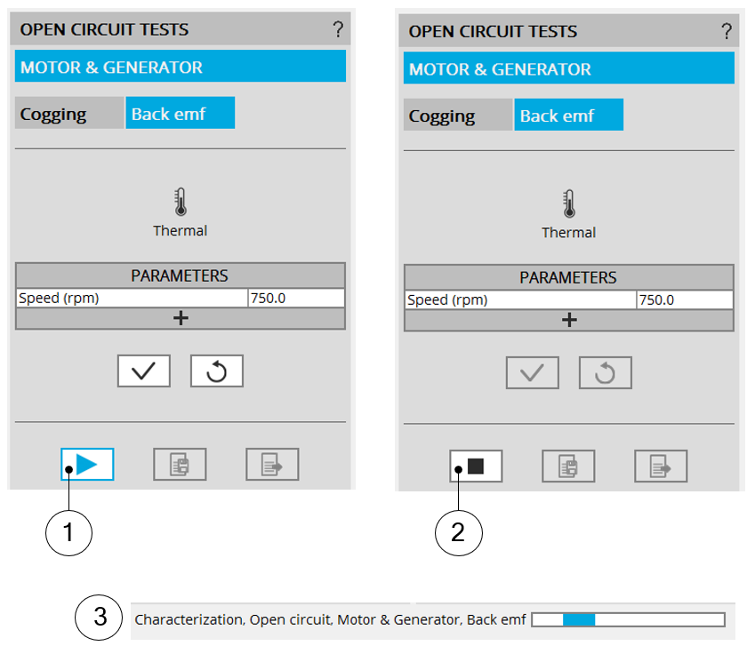

To start the test, click on the Start test button (1).
Note: Before running the test, even if the dedicated button to
validate input parameters has not been used, all the input parameters are automatically
validated and recorded .
When the solving begins, the Start test button (1) turns into Stop button (2).
During the computation a progress bar appears (3). At any moment, the computation can be stopped by clicking on the Stop button (2).
