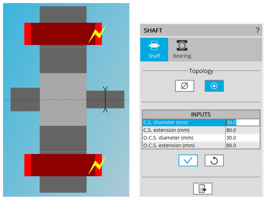

1. Shaft type
Two types of shaft can be selected:
- None: A shaft is not represented in the rotor design. It is
replaced by a fluid (like air)
- Solid: Shaft is represented and considered in the rotor design.
It is built with a solid material or laminations
| Shaft type: None |
Shaft type: Solid |

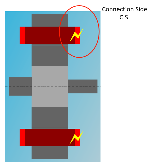

| Dimensions are illustrated with arrows |
Connection side (C.S.) is identified by yellow
lightning. |
2. Inputs
Label
Symbol
Tooltip, note, formula
| C.S. diameter |
D1 |
Connection side end-shaft diameter. |
| C.S. extension |
L1 |
Connection side end-shaft extension. |
| O.C.S. diameter |
D2 |
Opposite connection side end-shaft diameter. |
| O.C.S. extension |
L2 |
Opposite connection side end-shaft extension. |
