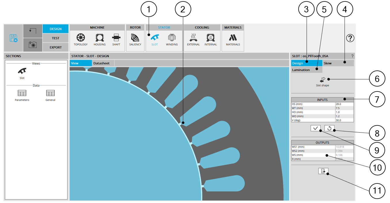

| SLOT design area | |
| 1 | Selection of the STATOR subset: SLOT panel (Click on the icon SLOT) |
| 2 | Visualization of the motor radial view to see the slot topology and dimensions. |
| 3 | DESIGN tab indicates the tools to define the slot parameters. Note: By default, Design tab is selected. |
| 4 | SKEW tab indicates the tools to define the slot skew angle |
| 5 | LAMINATION tab indicates the tools to define the shape of the lamination.Note: By default, Circular lamination is selected. |
| 6 | "Slot shape" button allows accessing the slot libraries to change the slot topology.See additional information below. |
| 7 | User input parameter fields to enter the value. |
| 8 | Button to restore default input values. |
| 9 | Button to Apply inputs. Pressing the enter key twice applies inputs too. |
| 10 | Output parameters (read only data) to complete the description of the topology. |
