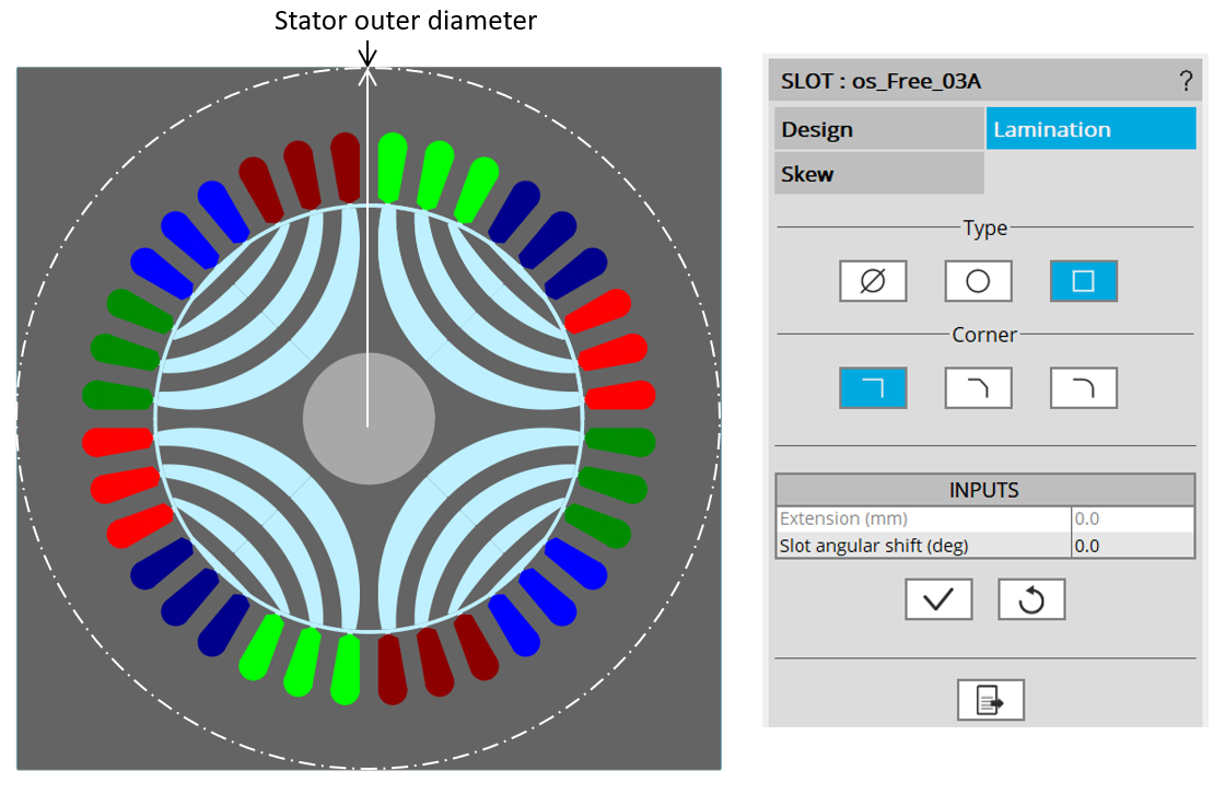

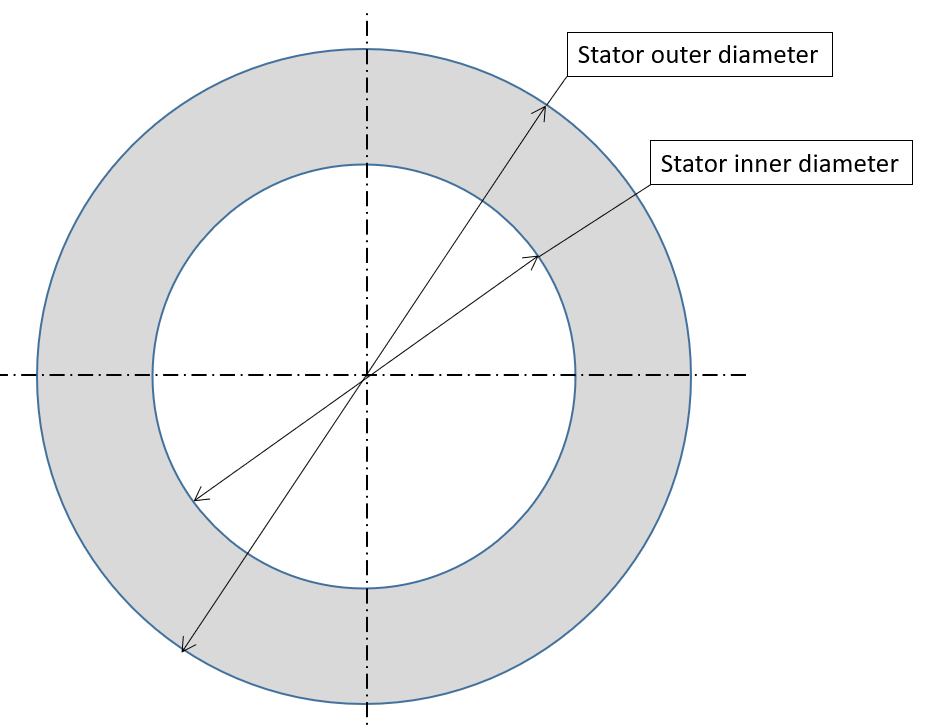

By default, the outer shape of the lamination is defined by considering the outer diameter of the stator (defined in structural data).
When the choice of lamination is “None”, original structural data of the stator are considered.
In that case outer shape of lamination is circular without extensions. Outer dimensions of lamination are indicated in general data (structural data part). See illustration below.
| Original structural data of the stator: Outer and inner stator diameters |

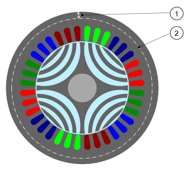

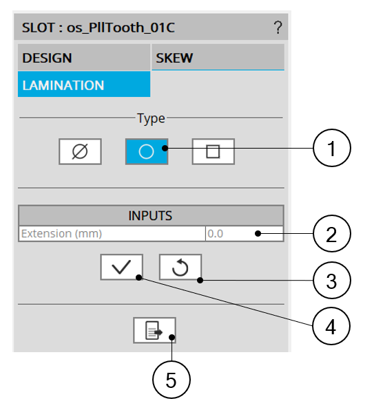

2. Circular shape lamination
1 | Choice of a circular shape lamination |
| 2 | Additional lamination extension. This corresponds to a diameter extension from the original stator outer diameter defined in the general data (structural data of the machine). See illustration below. For new design, this input won’t be available anymore. |
| 3 | Button to restore default input values. | |
| 4 | Button to Apply inputs. Pressing the enter key twice applies inputs too. | |
| 5 | Icon to export lamination data into *.txt or *.xlsx files. |
1 | Extension = Diameter extension from the original stator outer
diameter. Note: For new design, this input won’t be
| 2 | Original stator outer diameter defined in the general data (structural data of the machine). |

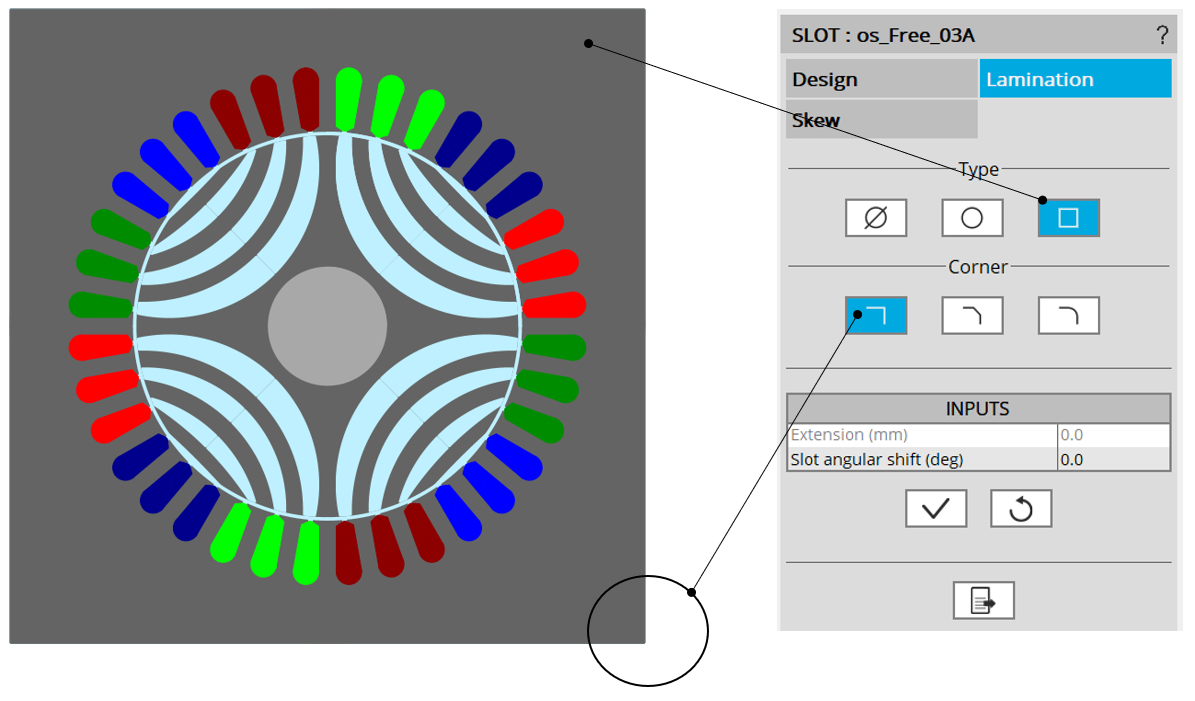

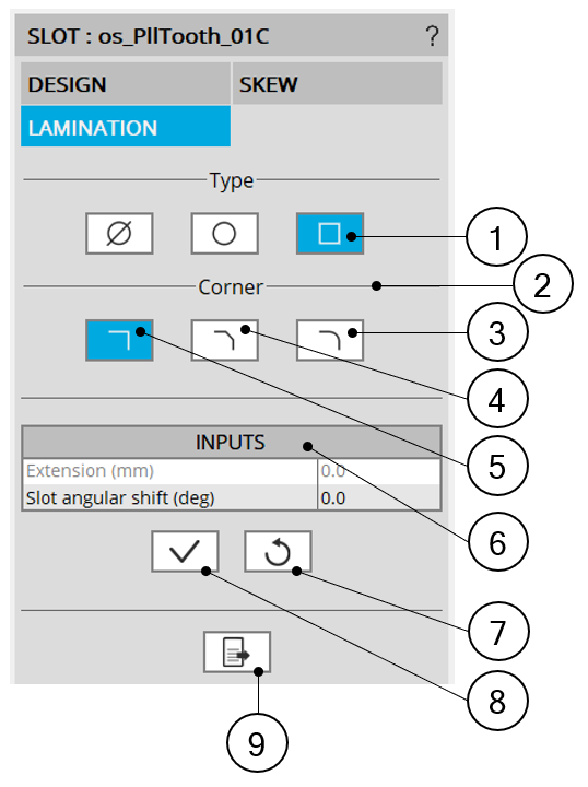

3. Square shape lamination
1) Main inputs
1 | Choice of a square shape lamination. |
| 2 | Corner type available (Right, Chamfer, Fillet). | |
| 3 | Button to select “fillet” type corner. | |
| 4 | Button to select “chamfer” type corner. | |
| 5 | Button to select “right” type corner. | |
| 6 | User input parameters to define the angular shifting of the stator.
Note: For new design, extension won’t be available
any more. |
| 7 | Button to restore default input values. | |
| 8 | Button to apply inputs. Pressing the enter key twice applies inputs too. |
| 9 | Icon to export lamination data into *.txt or *.xlsx files. | |

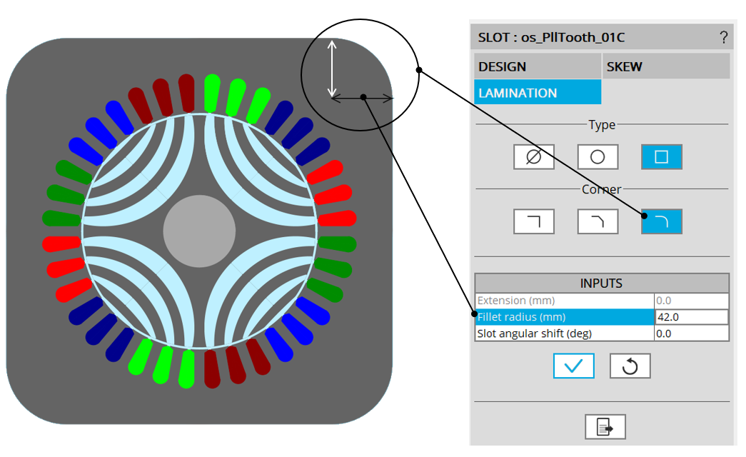

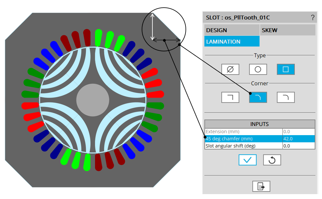

2) Description of the different kinds of square shape lamination available
| Square shape lamination with right corner | Square shape lamination with chamfer corner Setting of the length corresponding to a 45° chamfer |
| Square shape lamination with fillet corner Setting of the lamination fillet radius | Square shape lamination with right corner See the link with stator outer diameter |

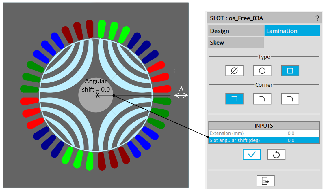

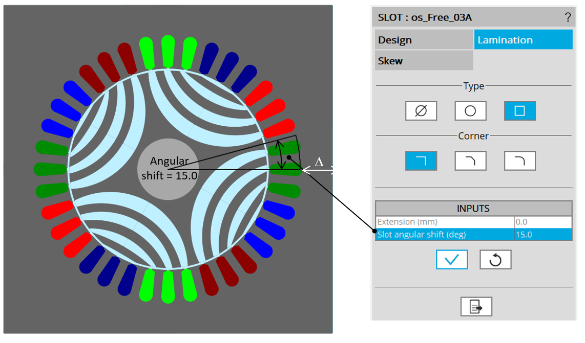

3) Definition of the slot angular shift
With a square shape lamination, it is possible to set a slot angular shift. It is advised to keep an angular shift lower than one slot pitch.
This parameter allows adjusting outer dimension (D) between outer border of the lamination and the bottom part of slots. For more details see the illustrations below.
| Square shape lamination Definition of the slot angular shift = 15.0 i.e., half value of the slot pitch. |
| Square shape laminationDefinition of the slot angular shift = 0 i.e., original default value. |
