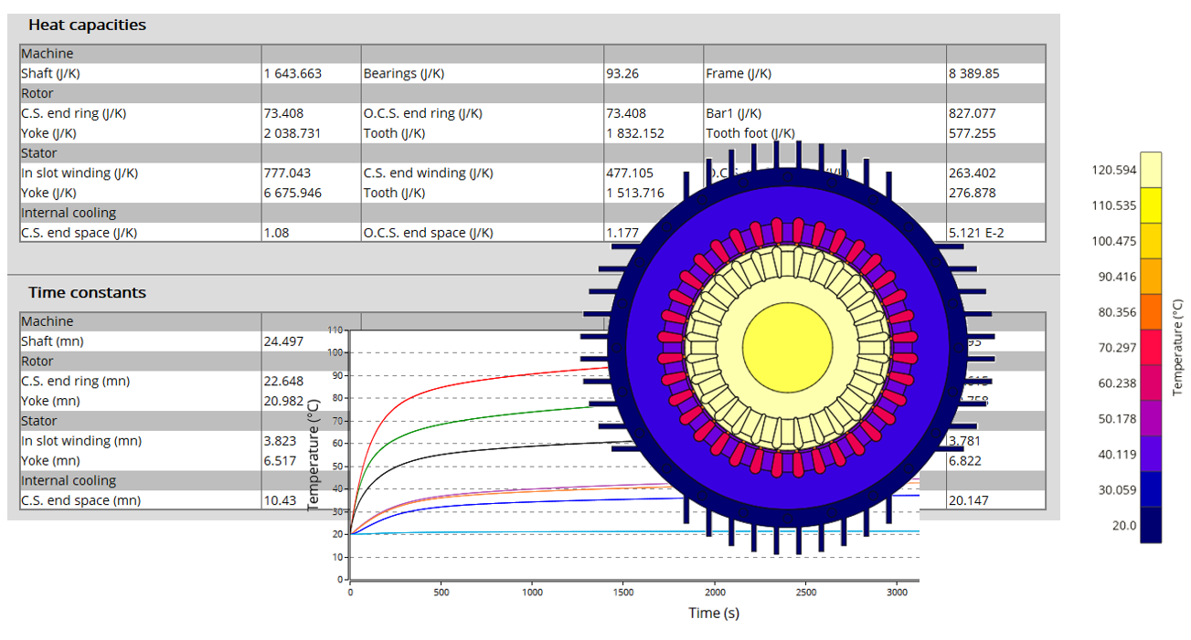

The aim of “Characterization – Thermal – Motor & Generator – Transient” test is to evaluate the impact of electromagnetic performance on thermal behavior of the machine in a transient mode.
A thermal working point defined by a speed and a set of losses can be considered to compute the temperature charts and the main thermal parameters. The inputs describing the thermal working point can be set manually or imported from electromagnetic tests that were previously solved.
In addition to that, a maximum evaluation duration and a time step are added as inputs to set the transient mode.

Here are the main results available:
- Temperature charts versus time – radial and axial view
- Main temperature curve versus time and final temperature table
- Heat capacity and time constant table
