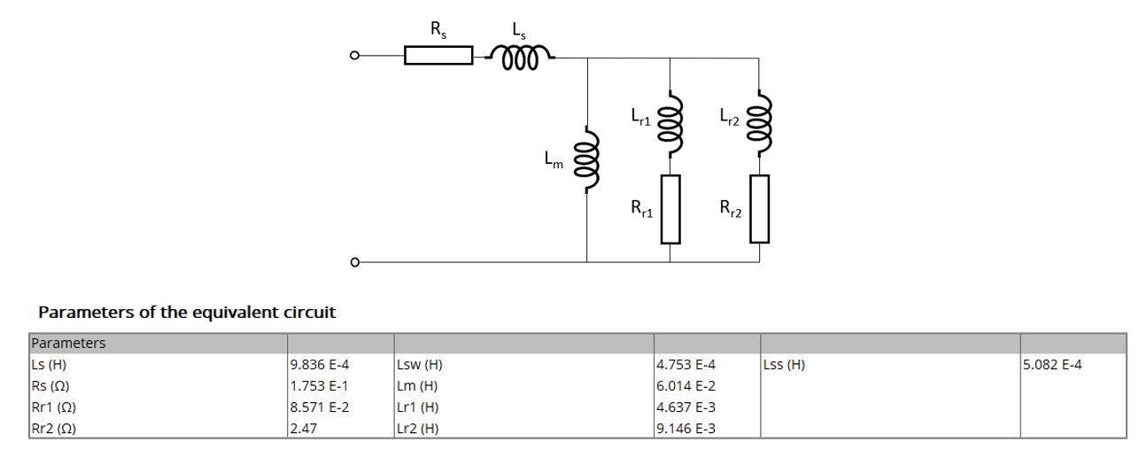

3. Main outputs
The main outputs are all the computed parameters of the equivalent scheme (First or second order).
The quality of results is also illustrated with the superimposition of the magnitude and phase of the operational inductance is computed either with Finite Element software Flux2D (Steady State AC application) or analytically by considering the resulting operational inductance.
3.1 Table or results
Equivalent scheme parameters
- Operational inductance Laplace function with the corresponding computed parameters
- Induction machine equivalent scheme (first and second order) with its associated computed parameters
- Model evaluation – Start-up characteristics
