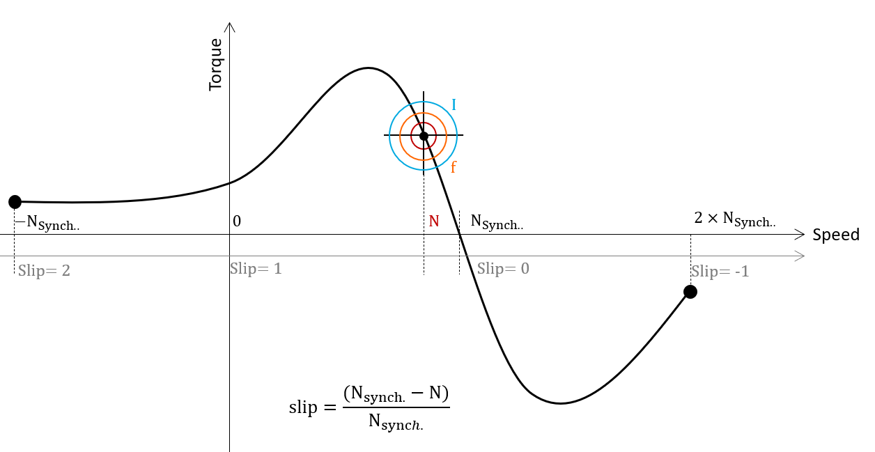

| “Working point – Sine wave – Motor – I, f, N” Illustration |

The three main user input parameters are the line current, the power supply frequency, and the speed (or the slip). In addition, temperatures of winding and squirrel cage must be set.
