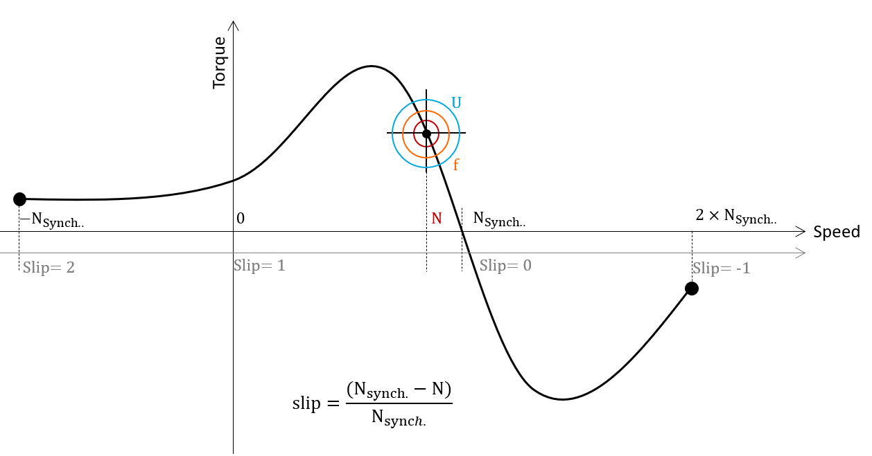

| “Working point – Sine wave – Motor – U, f, N” Illustration |

The three main user input parameters are the supplied Line-Line voltage, the power supply frequency, and the speed (or the slip). In addition, temperatures of winding and squirrel cage must be set.
