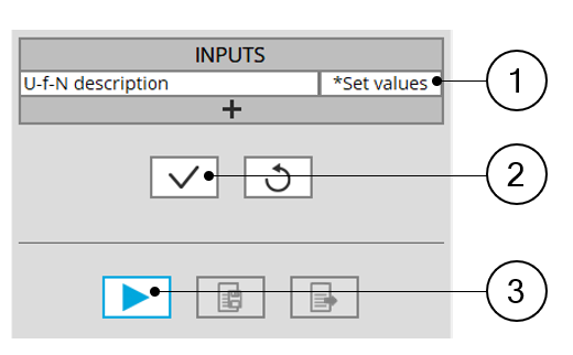

| List of working points to be defined | |
| 1 | Click on the button “Set values” of the field “ U, f, N description” to define the working points in a dialog box. Refer to the next illustration which shows how to fill the working point table. |
| 2 | Button to validate the user input data |
| 3 | Button to run the computations |

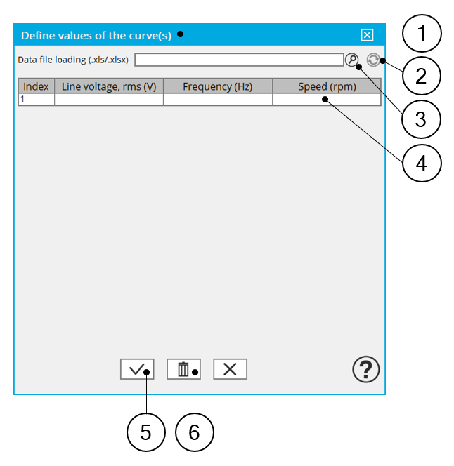

| Dialog box to define the list of working points | |
| 1 | Dialog box opened after having clicked on the button “Set values” in the field “Cycle description” |
| 2 | Browse the folder to select an Excel file to define the working points to be considered |
| 3 | Button to refresh the table data when the considered Excel file has been modified |
| 4 | Fields to be filled with data to describe the list of working points to be considered |

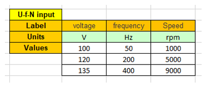

| Excel file template to define the list of working points |
