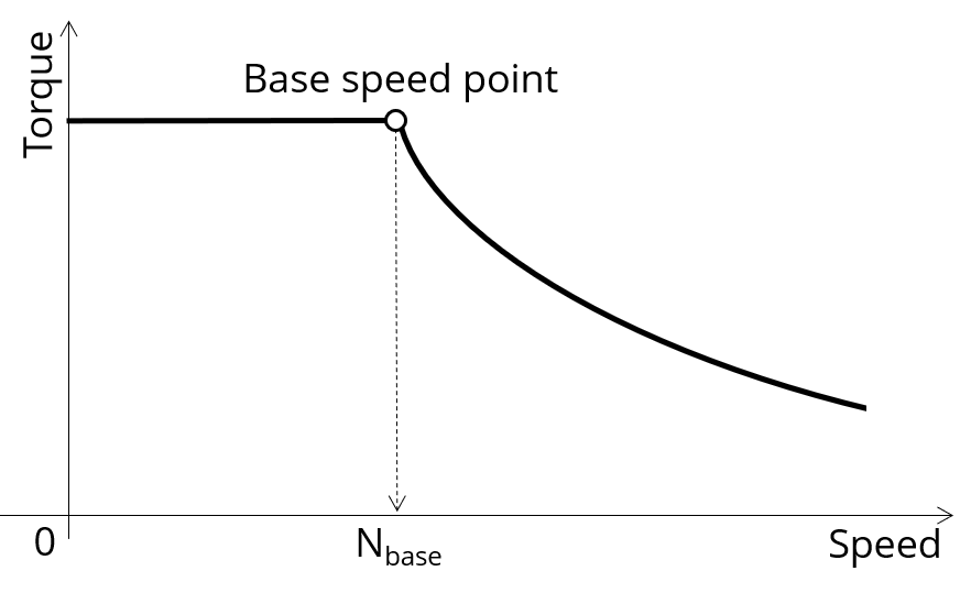

| Characterization of the corner point on the torque-speed curve |
In the results, the performance of the machine at the base point (base speed point) and for the maximum speed set by the user are presented.

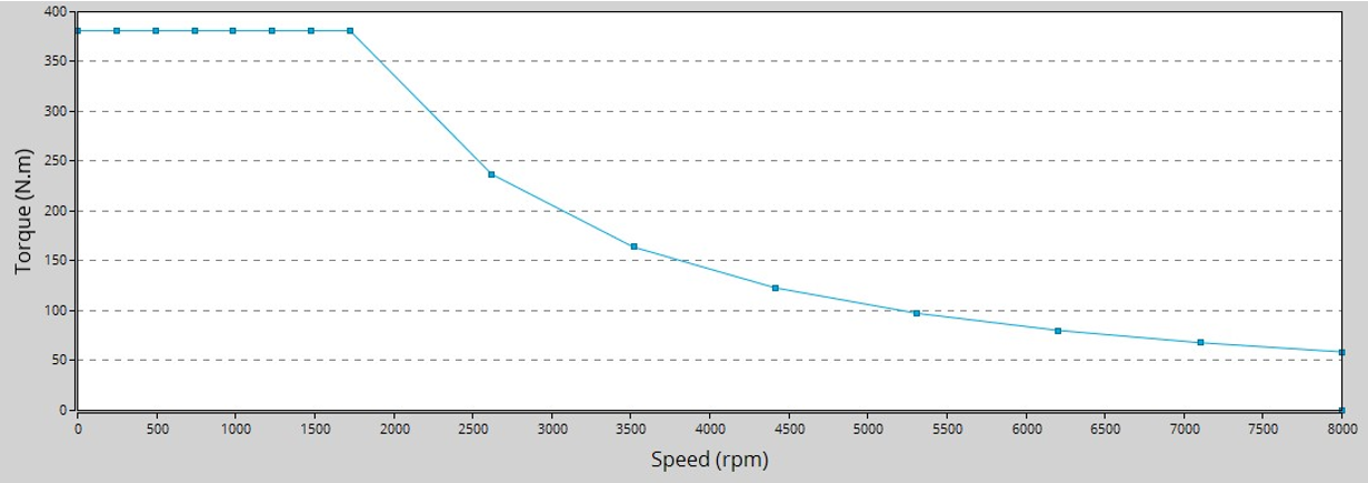

| Mechanical torque versus speed - Example |

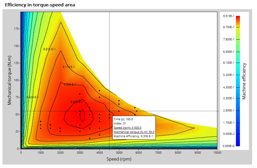

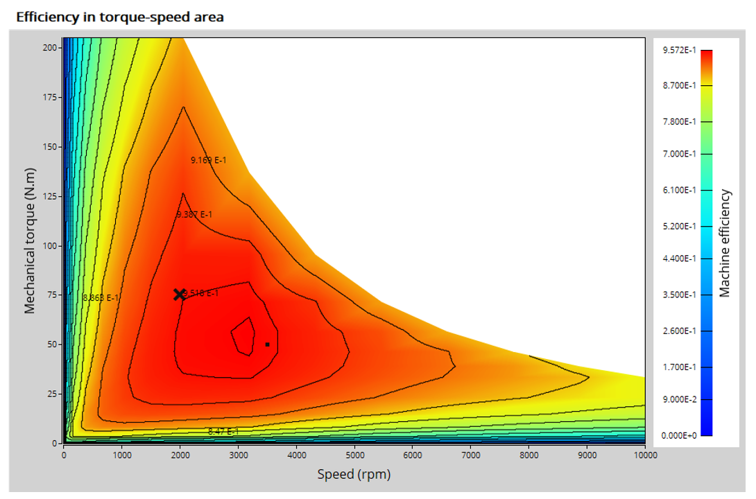

| Efficiency in torque-speed area - Example |

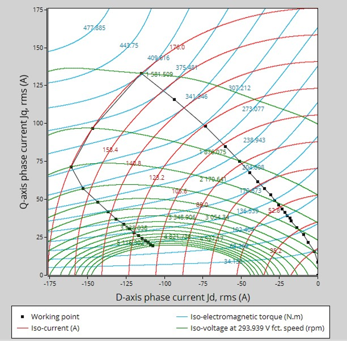

| Characteristics curves in J d -J q area - Example |

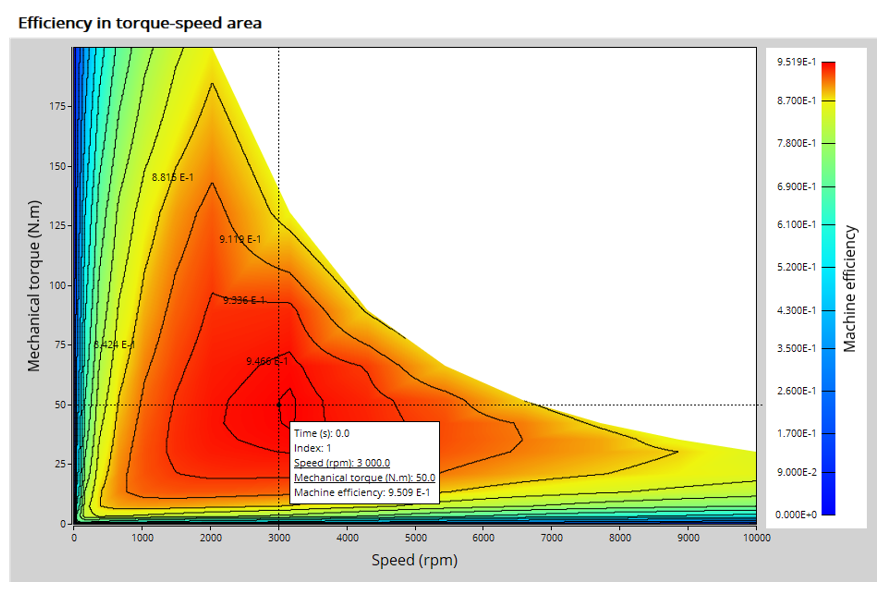

The first one allows extracting one torque-speed point from the efficiency map to get the machine performance, for this specific working point (general data + power balance).
Note: The considered working point is then displayed on all the maps available.
| A “single” working point displayed on the efficiency map - Example |
The second feature allows the user to define a duty cycle by giving a list of working points (speed, torque) versus the time. The displayed results illustrate the machine performance over the considered duty cycle (mean, min, and max values).
The time variation of the main quantities is also displayed (Mechanical torque, speed, control angle, current, voltage, power, efficiency, losses).
All the corresponding points are displayed on the different provided maps.
| A “Driving cycle” displayed on the efficiency map - Example |

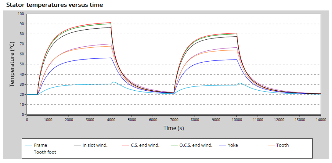

2.2 Driving cycle with thermal solving
When the "thermal solving" is selected in the settings, the machine temperatures are computed over the driving cycle.
The variation of the machine performance are computed and displayed over all the driving cycle time.
| The machine temperature variations can be evaluated all along the driving cycle |
| A working point of the driving cycle can be selected for displaying the corresponding machine electromagnetic performance |

Characteristic curves
- Electromagnetic torque versus current and control angle (Y) according to base speed point
- Characteristic curves in Jd-Jq area - Evolution of the working points in Jd-Jq plane, with iso-torque, iso-current and iso-voltage.

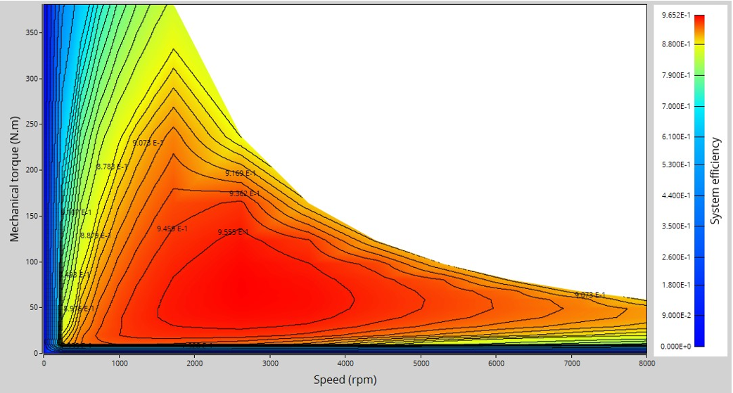

Torque-Speed maps
- Efficiency in torque-speed area
- Current (J, Jd, Jq) in torque-speed area
- Voltage (V, Vd, Vq) in torque-speed area
- Control angle in torque-speed area
- Power in torque-speed area (Mechanical power and electrical power) in the torque-speed plane
- Power factor in torque-speed area
- Losses in torque-speed area (Total, Joule, Iron, Mechanical and additional) in the torque-speed plane
