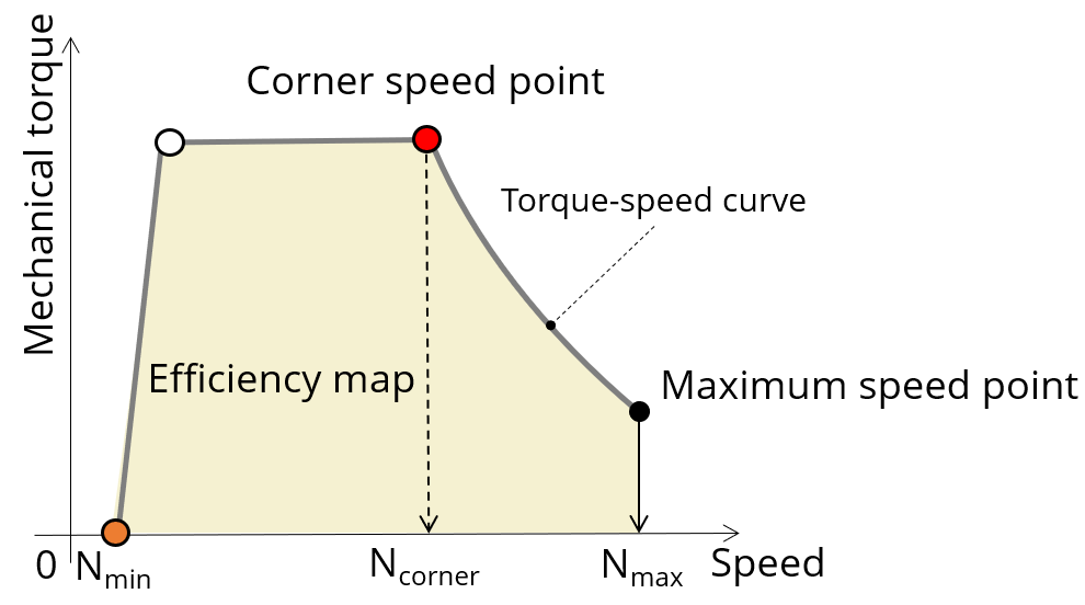

| Characterization of the corner speed point on the torque-speed curve |

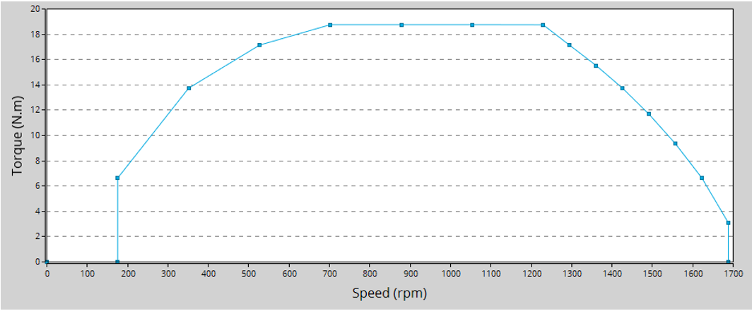

In the results, the performance of the machine at the corner speed point and for the maximum speed set by the user are presented.

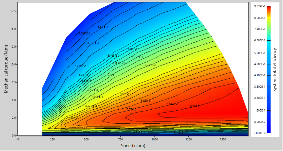

A set of curves (like Torque-Speed curve) and maps (like Efficiency map) are computed and displayed.
| Mechanical torque versus speed - Example |
| Efficiency in torque-speed area - Example |
These results help the user to understand the possible performance of the machine in its electric environment.

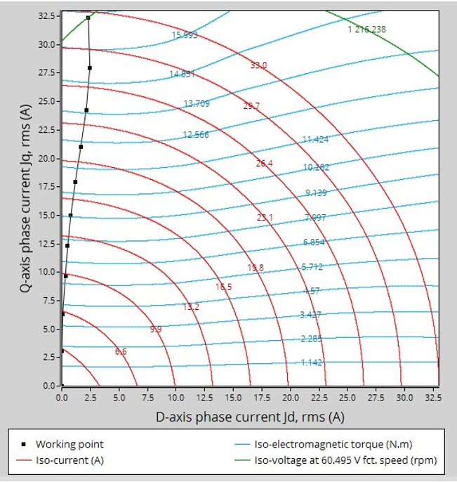

| Characteristics curves in J d -J q area - Example |

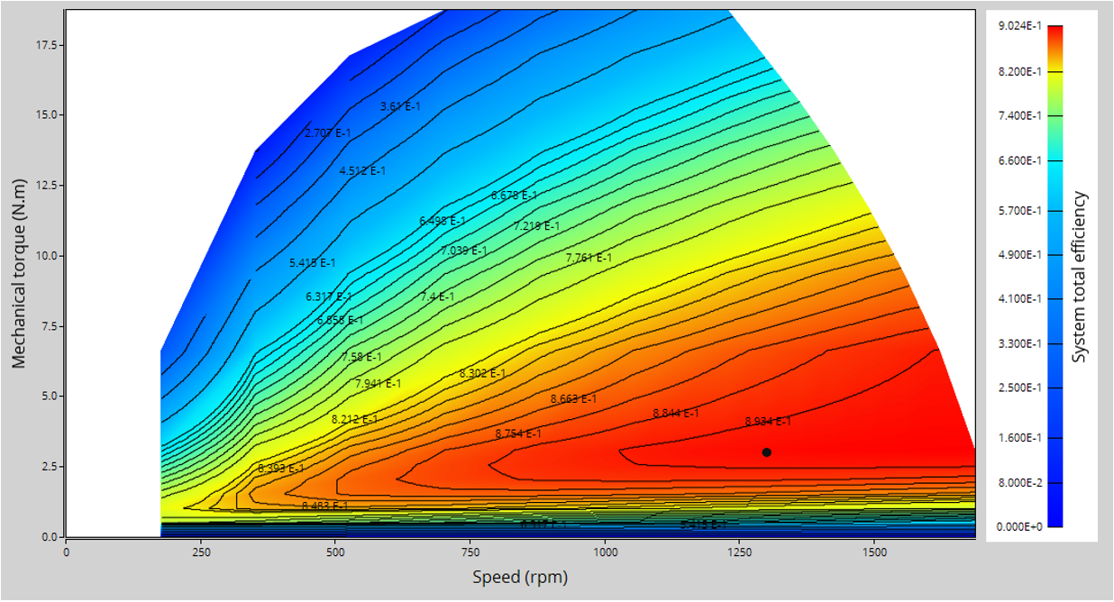

Moreover, two additional features are available in this test.
The first one allows extracting one point from the efficiency map to get the machine performance, for this specific working point (general data + power balance).
| A “single” working point displayed on the efficiency map - Example |
