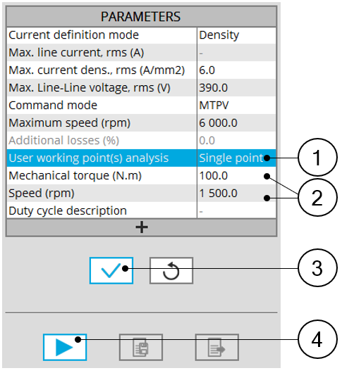

User working point(s) analysis = Single point
This allows computing the machine performance on a working point which must be specified by the user with the targeted speed and torque.
In that case the next two fields must be filled in with the targeted speed and mechanical torque.
User working point analysis = Single point 1 Select the “Single point” option to perform a computation on one working point. 2 Define the targeted working point mechanical torque and speed. 3 Button to validate and take into account the user inputs 4 Button to run the computation -

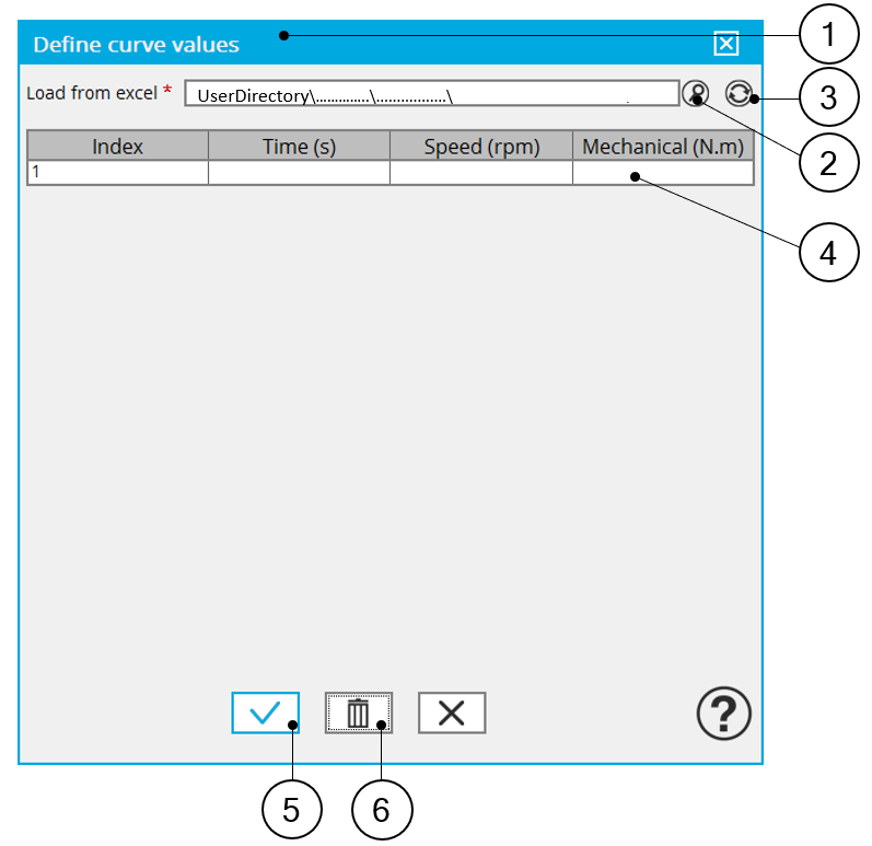

This duty cycle must be defined by using the next field: "Duty cycle description" and by clicking on the button "Set values".

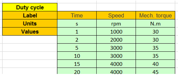

Two ways are possible to fill in the table: either filling the table line by line or by importing an excel file in which all the working point of the duty cycle are defined.

| User working point analysis = Duty cycle – Dialog box to define the duty cycle | |
| 1 | Dialog box opened after having clicked on the button “Set values” in the field “Cycle description” |
| 2 | Browse the folder to select an Excel file in which the duty cycle is described. |
| 3 | Button to refresh the table data when the considered Excel file has been modified |
| 4 | Fields to be filled in with data to describe the duty cycle to be taken into account |
| Excel file template to define the duty cycle |

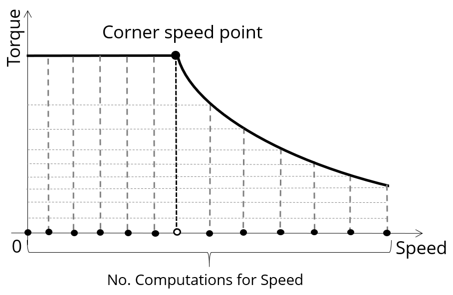

Number of computations for speed
The “No. comp. for speed” ( Number of computations for speed ) corresponds to the number of points to be considered in the speed range from 0 to the maximum speed.
Half of these points are distributed from 0 to the base speed. The remaining points are distributed from the base speed to the maximum speed.
In both cases, base speed is considered as an additional point.
Note: If the user input parameter “ No. comp. for speed ” is an odd number, one discretization point is automatically removed.
| Definition of the number of computations for speed |
The default value is equal to 15. The minimum allowed value is 5. The maximum recommended value is 40.
Note: Increasing the number of computations can improve the convergence of the optimization used to define the torque-speed curve and the efficiency map. However, that also means longer computation time.

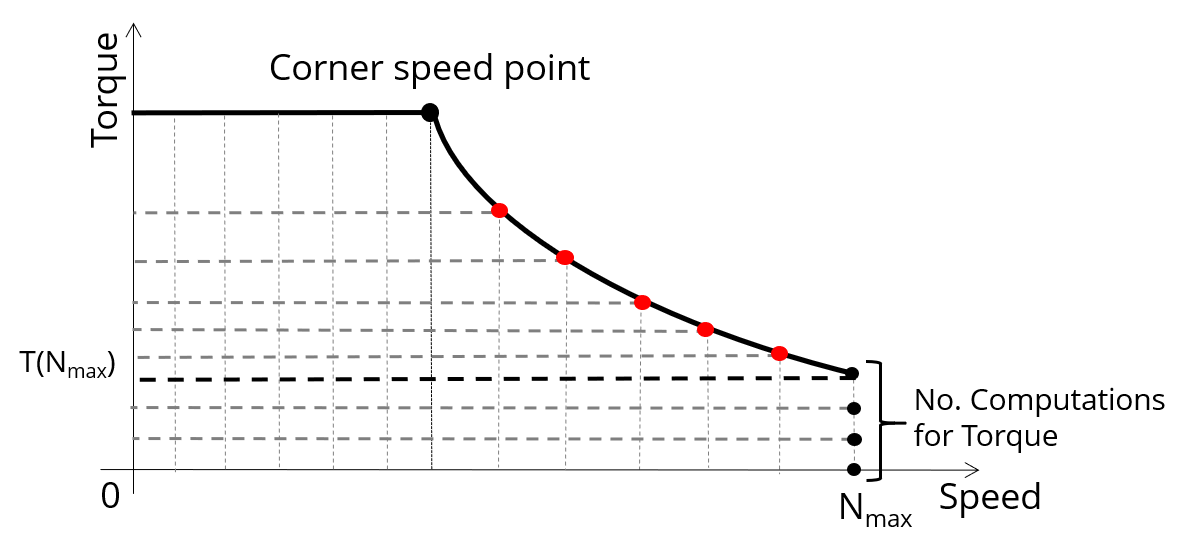

Number of computation for torque
With the Low Speed command mode, the number of computation for torque is imposed by the input parameter “ No. comp. for torque ” (Number of computations for torque) - Black points in the graph shown below.
The default value is equal to 7. The minimum allowed value is 3. The maximum recommended value is 20.
The number of computation for torque is imposed by the number of computations for speed in the speed range [N base ; N max ] (Red points in the image shown below).
The advanced user input parameter “ No. comp. for torque ” allows to finalize the grid within the torque range [0, T(N max )] at the maximum speed (Black points in the image shown below).
| Definition of the number of computations for torque – MTPV command mode |
