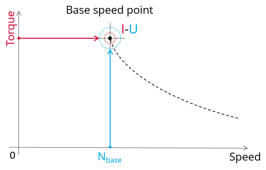

1. Positioning and objective
The aim of the test “ Working point – Sine wave – Motor – T, N” is to characterize the behavior of the machine when operating at the working point which is targeted by the user. It corresponds to the base point at a targeted useful torque and speed.

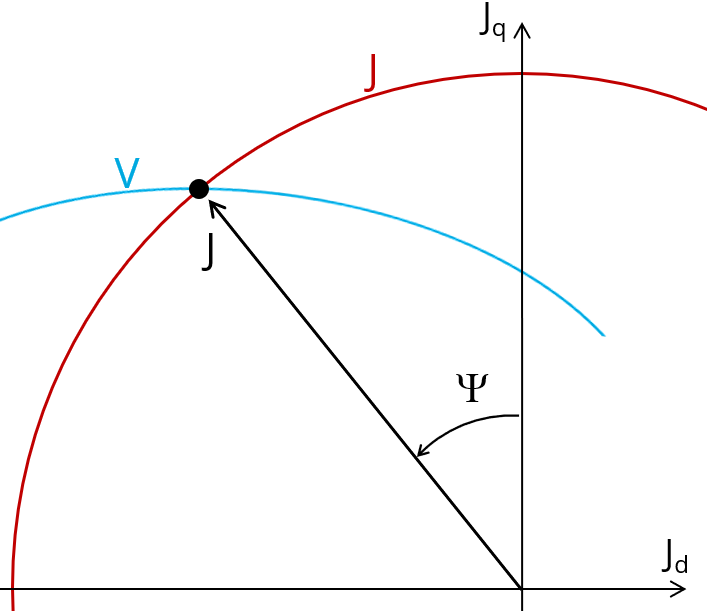

The working point torque-speed is defined by considering the targeted input values T, N (useful torque, speed).
This test allows defining the required line-line voltage and line current to reach the targeted useful torque and speed for the considered command mode (MTPV, MTPA or maximum efficiency).
| Working point – Sine wave – Motor – T,N - Illustration | |
The results of this test give an overview of the electromagnetic analysis of the motor considering the machine topology.
The general data of the machine, like machine constants, power balance and magnet behavior are computed and displayed.
The magnetic flux density is also computed in every region of the machine magnetic circuit to evaluate the design.
